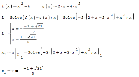

Here comes an image. This may show up differences with smath or maxima versions.
#6 Опубликовано: 12.03.2019 08:51:00
L is differently defined in the two versions (use the dynamic assistant by mouse hovering over the definitions to see the difference)
in the second case, L isnt't stored in evaluated shape, thus vectorize() doesn't recognise the expression as vector and executes the expression only once.

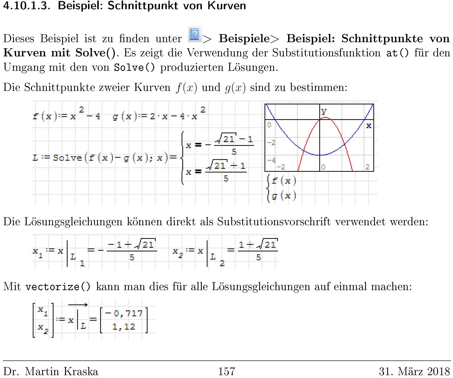

But how can i get L stored in evaluated shape?

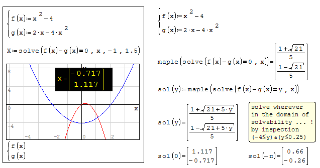

In your example:
it works nice.

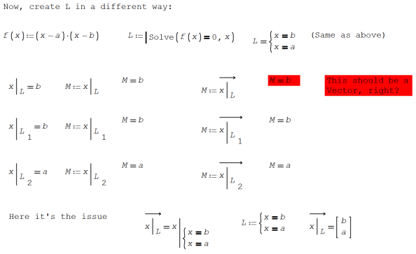

If i try the same
it does not. Did i miss an configuration?
#8 Опубликовано: 12.03.2019 10:19:30
... plot first, solve(,,,,) native Smath.

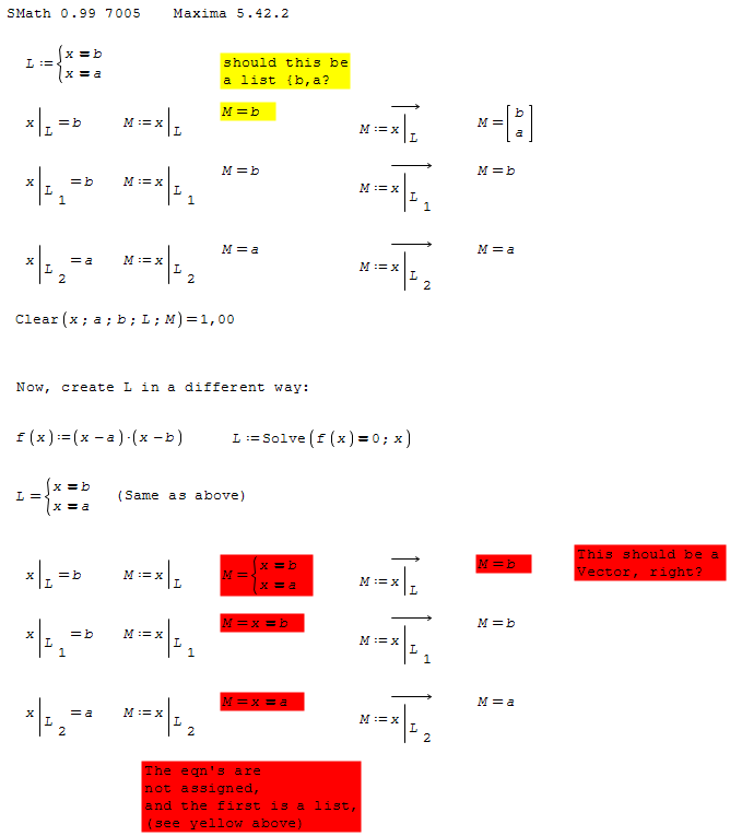

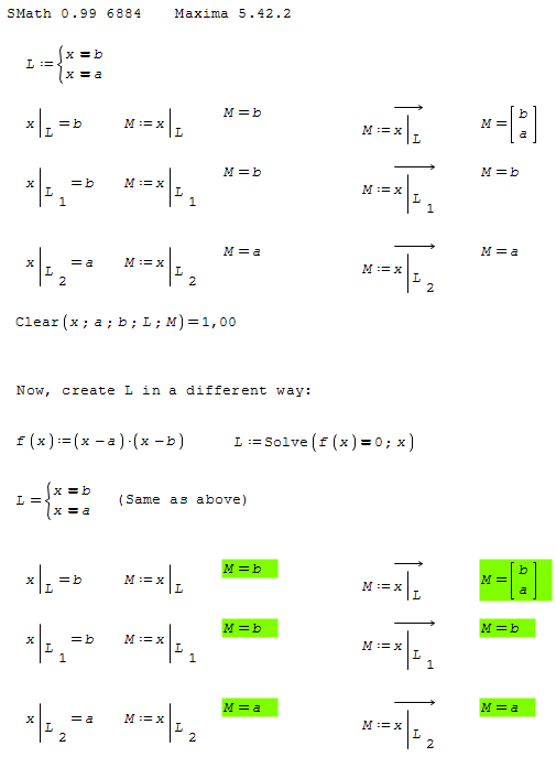

I found the difference between Program Versions.
I tried V0.99.6884 and all works as expected.
L is now assigned identically for both definitions.
The bug may be not located in at().
#11 Опубликовано: 12.03.2019 12:21:16
It seems that the evaluation logic in the plug-in interface has changed.
The function Solve() indeed shows a different behaviour (not evaluated/simplified when used in definitions, as if it was behind a line operator)
Other functions like int() don't seem to be affected by the problem.
Blatt39.sm (6,81 КиБ) скачан 1458 раз(а).
