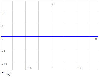

When I right click on the graph and try to animate, I get "t not defined."

WroteWhen I try to animate, I get "t not defined."
SS 6179 is more convivial:
"plot then define animation variable"
Click over the plot then set the animation, variable.
I right click on the graph and then select animate t.
I select 2 frames per second.
Still get error, t not defined.
test.sm (3 КиБ) скачан 1216 раз(а).
