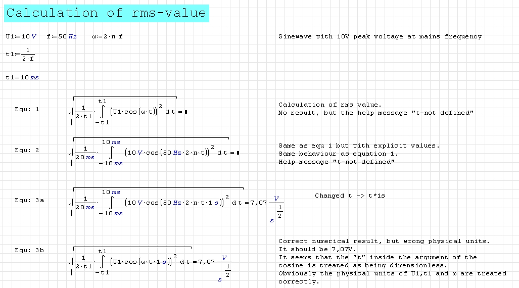

Hello everybody,
I have tried some calculations with Smath and got surprising answers ( surprising for me ). Now the question is
1. did I make an error ?
2. did I expect something that is not implemented ?
3. is there a bug in Smath ?
I´m sure, the comunity can pick the correct answer.
The first example is connected with the integral function and units. The underlying attempt was to calculate the rms value of a sinusoidal voltage.
( I hope the following screenshots are self-explanatory )

It was already answered in some another post.
1. Do not use definite integration with units. Definite integration is numericaly implemented in SMath and not ment to work with units. Your experimentations with it showed that as well.
2.When you hoover with the mouse on dbwM(x) you could see that the symbolic processor have log(x) in the expression - this is not allowed with units. You just have to force the RHS of the function definition to use "eval" function. For instance you can put all the expression of the RHS of the function definition inside the "eval" or just put only "eval(x/1mW))" and the function will work as expected.
