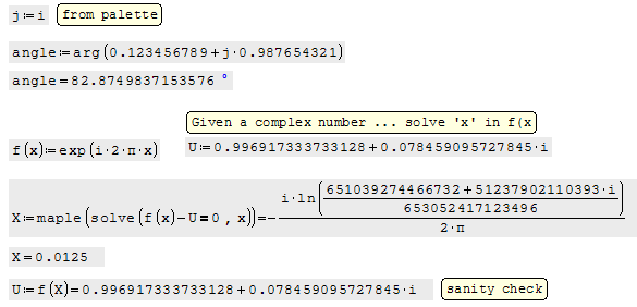

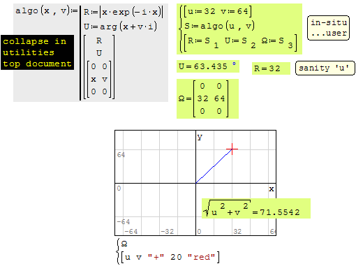

Show your example of complex converted to A*e^j*φ

Thanks for reply.
About j := i
I know that it can be expressed in SMath another way, for ex. like this:
But, It is very helpful that it can be represented in result (answer) just like this:
Z := (0 − j*50) Ω = 50*e^-j90° Ω
or like this
Z := (0 − j*50) Ω = 50∠−90° Ω
