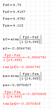

I am using version 0.87.3728. I performed the calculation below:
As you can see the answer should be simply -0.4063804, but Smath added an unwarranted, very small imaginary number to the answer.

#2 Опубликовано: 25.03.2010 17:49:31
Hello Will,
I tried this on 0.87 stable (0.87.3692)
Could you double check it. This looks to me Ok, although quite different from your result.
I again forgot to bring 0.87 Beta with me, sorry. I'll check this out tomorow.

#4 Опубликовано: 25.03.2010 21:19:50
You are welcome ,
You might be right. I mentioned some odd behavior wnen using trigonometric fuctions with units arguments in the first Beta. Andrey fixed that. It might remain some unfinished work on the same issue.

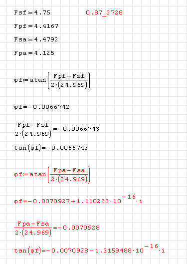

#5 Опубликовано: 26.03.2010 07:24:13
Hello Will,
Here is the 0.87_3728 version of your example made on my computer.
It is again different than yours but closer to mine previously made on 0.87 Stable.
I think that the imaginary part could be freely neglected here (less than 10^(-15). If the SMath would have had the system of representing results with the given precision, this imaginary part would have not been presented here. Therefore, I suggest you to use just the real part of the results.
On the other hand I am not sure why our results are so different?

#9 Опубликовано: 29.03.2010 15:50:04
Hello Will,
I suppose that SMath should have Zero and Complex treshold in order to avoid these situations. This way would overcome the mentioned problems.
#10 Опубликовано: 29.03.2010 18:02:03
2 325 сообщений из 4 013 понравились пользователям.
Группа: Super Administrator
Agree with you. Will implement this.
