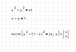

How do I solve this system of equations?
How do I solve this system of equations? - I'm trying to use sMath to solve it, but I don't know how to enter it. Do I have to use the elimination method? Sorry, I'm still a beginner. - Сообщения

Is using the solve function the only way to solve this? Are there other, perhaps better, methods?

Here you can see how to solve systems of equations in several ways. There are other examples if you search them.
