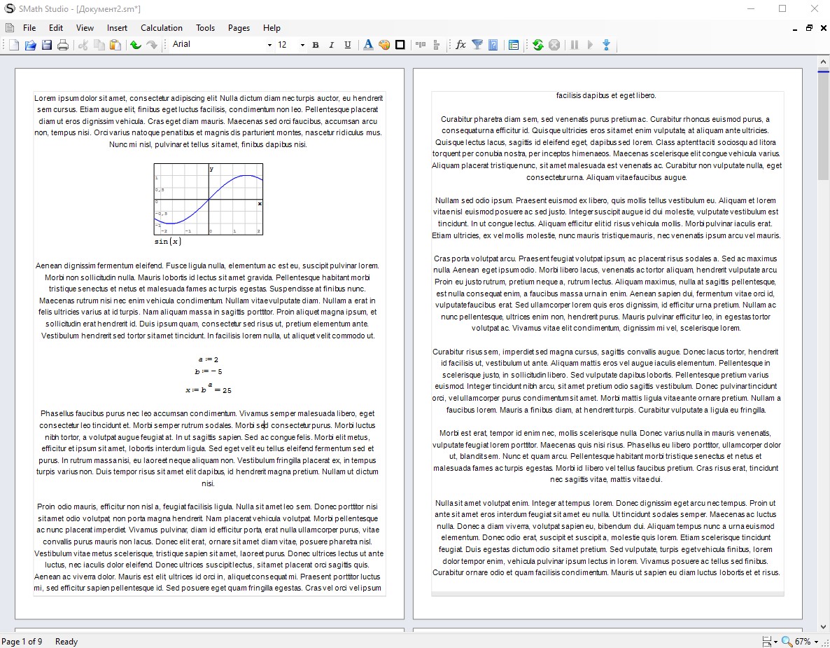

Here is a new beta release of SMath Studio: https://en.smath.com/forum/yaf_postst20001_Beta--SMath-Studio-0-99-7632--23-November-2020.aspx
It includes very interesting feature which was a goal for me for last couple of years. During this time I had to review/implement many parts of SMath Studio to make this possible. Feature is called Document mode.
The main idea is that there are two modes of the documents should be supported by SMath Studio:
  1. Worksheet - equations has the first priority! - standard mode of the program;
  2. Document - text has the first priority! - new mode
Document mode is a mode when one is working with a file like in MS Word. This is a text processor with possibility to insert equations. The only difference is that these equations are automatically calculated!
What to expect:
  • There is no red cursor anymore;
  • Enter can be used to make line breaks (no need to press Ctrl or Shift to make it work);
  • Everything is vertically aligned by a baseline.
Important note is that adding this new feature does not mean standard Worksheets will be killed! Actually Documents are implemented as lightweight versions of the Worksheets, so these two modes are connected. In other words Document mode is a bit customized Worksheet which always has only one Region inside and this one Region supports any other Regions inside itself. One may noticed that Text Region can be used as a container for other Regions and Document mode is a real reason why this was introduced. Pages view, line/page breaks and many other stuff was implemented to reach the same goal.
And now I want to introduce a very early version of this mode.
Currently it is a bit hidden, so regular user will not use functionality which is not ready and not tested enough. Here is an instruction about how one can make Document mode enabled:

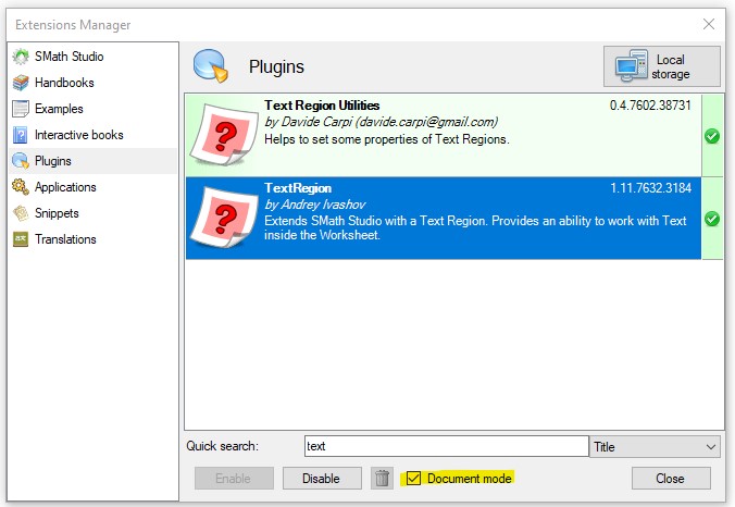

  1. Open Tools > Plugins..., find and select Text Region, set Document mode checkbox checked:
  2. Find a New document item in File menu:
I think there is nothing to describe more except one thing: equations should be added to text using Alt+= keystroke or using Insert menu.
This is a very first version, so it has many obvious issues, like:
  • Text Cursor is not blinking;
  • Poor text formatting capabilities;
  • Collapsed Area Region is not supported;
  • Some shortcuts do not work in new Mode;
  • Not all sentences translated.
I will work to fix all of them and many others in nearest future.

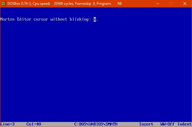

That's could be not an issue, but a feature. Just make it an square without blinking, like in Norton Editor! It's more peaceful write without a cursor continuously blinking in front of the user face.
You couldn't be any more right.
Nothing triggers me to write something more than a nonblinking cursor.

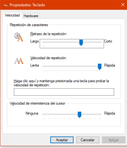

Blinking cursor makes easier for the brain to spot immediately the position (like when you have to spot the position of an animal in the wild). Solid cursor is nice but is a little bit odd with non monospaced fonts.
Alvaro 26.11.2020 16:45:00
#10 Опубликовано: 26.11.2020 16:56:22
1 134 сообщений из 1 804 понравились пользователям.
Ups. I'm not thinking about that. With proportional fonts it probably doesn't look as good, and a blinker free bar is harder to locate. Actually it's explained here, in french:

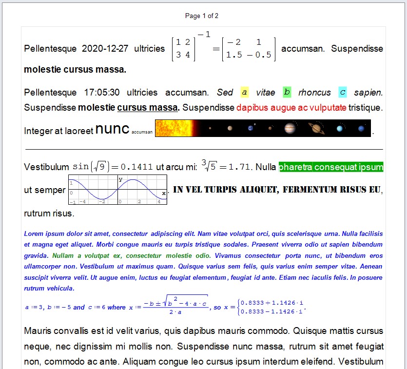

  • So, now it is possible to perform formatting of text fragments in Text Region, not only the whole content as it was before.
  • Another interesting feature is auto detection of equations (and horizontal rules) in the text: write 2+3 or anything else and program will automatically convert it to Math Region inside a text).
Of course all the features (except paragraphs in text) supported in Document and Worksheet modes of SMath Studio.
Currently I'm working to fix several issues in formatting capabilities, to allow creating links (anchors) for the text fragments and increase stability.
Some notes:
  • line interval and text alignment features currently available using context menu only;
  • Enter adds a paragraph, while Shift+Enter inserts a line break;
  • It is possible to copy formatted text or its part and paste to MS Word or any other program which supports HTML from clipboard;
  • Full back-compatibility for Worksheets created in previous versions of SMath Studio provided.
