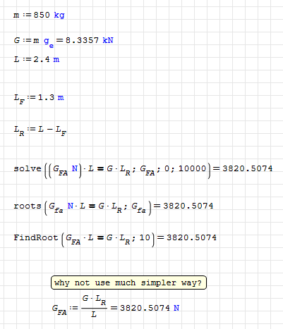

First of all hello to all
I'am a new forum user as well as the SMath, too.
So: I have a question-> please see the below input deck (I don't know how to input png file :/ )
m:=850kg
G:=m*ge
L:=2.4m
LF:=1.3m
LR:=L-LF
solve(GFA*L=G*LR,GFA)
off course ge is the gravity. The above input don't give me solution. Could you help me??
I hope that attachment file will be correctly attached
test.sm (4,06 КиБ) скачан 1207 раз(а).
best regards,
Astroneus

solve() calculates between -20/+20 unless different range is not specified.
This was your wrong doing here, result is way over 20. A well guessed range gives the result.
roots() must calculate without units like solve(), however you can fool functions by adding the unit of result.
Findroot() can calculate with unit but you have to give a starting guess value.
test_solve.sm (6,6 КиБ) скачан 1228 раз(а).

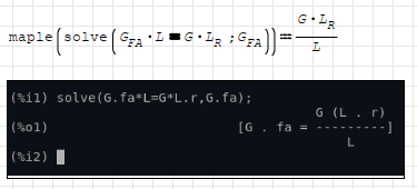

Btw. I installed the Maxima and I turn on the plugin in SMath. Could you tell me how to define the above equation for symbolic solution i.e. considering the GFa ???

I use linux, maxima plugin doesn't work for us. Can't show you as smath example.
However I have maxima as cli and it can solve your function
Maple plugin can solve as you asked too if optimization is set to symbolic.
The idea is same, way of doing it and result shouldn't differ on maxima plugin.

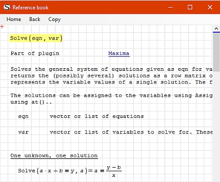

Mi Astroneus. If you have Maxima, you can use Solve(). For learn about it (and a lot of things about Maxima and SMath) you can download the "Interactive SMath Handbook" by M. Kraska. Under Tools menu choose the interactive books option. If you don't have it, try to change "Local storage" to "Online gallery". The you can open it. Solve it's under Mathematics / Solving Non-Linear Equations / Solve.
