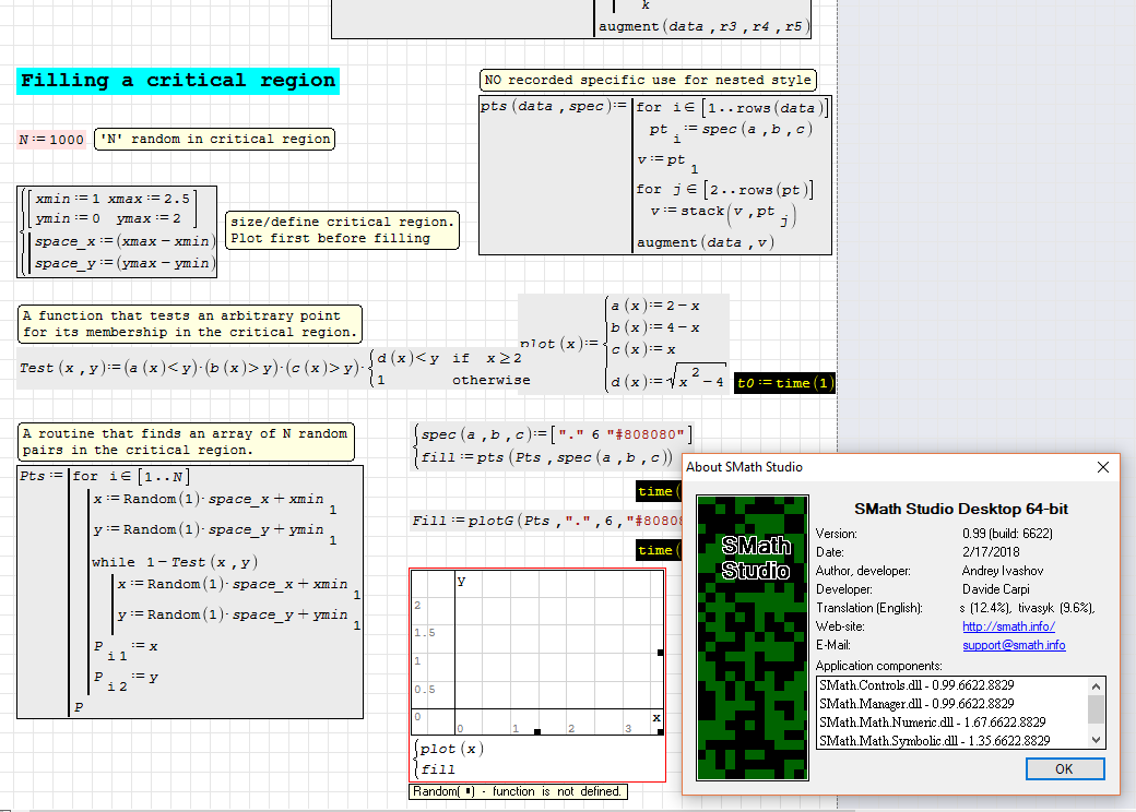

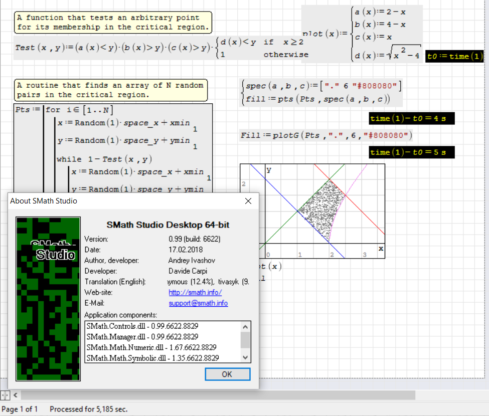

Jean,
It does not work in 6622.
In Graph: (does not display any graph)
Error: Random()= Function is not defined.
Thanks,
Basile
#3 Опубликовано: 18.02.2018 16:32:39
Группа: Super Administrator
Hello [USERLINK]Basile[/USERLINK].
It does work on my copy of 0.99.6622:
Tried different locales - everything seems ok.
Random(..) function is from Statistical Tools plug-in. Please check if this plug-in available on your PC.

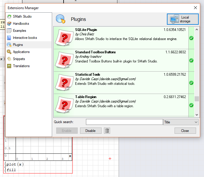

SMath-01.PNGHello Andrey,
Attached please find a print screen.
Am I doing something wreong?
Thank you,
Basile
#5 Опубликовано: 18.02.2018 16:50:32

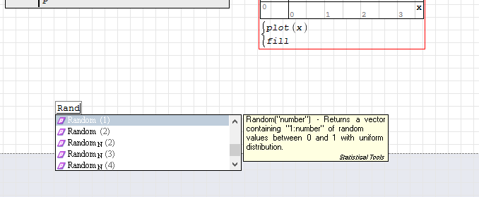

#6 Опубликовано: 18.02.2018 17:05:33
Basile
Basile
8 сообщений из 172 понравились пользователям.
SMath-02.PNGIt looks that it is...
#7 Опубликовано: 18.02.2018 17:21:15
Please could you check what plug-in handles Random function in your case?
Also please try to test Random function... will it work in most usual scenarios on your environment?

SMath-03.PNGHere it is...
And how do you want me to test the Rand, please?

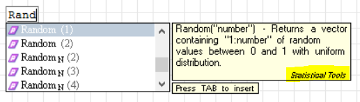

#10 Опубликовано: 19.02.2018 09:52:38
Basile
Basile
SMath-04.PNGJean,
I run your and I get:
Basile
#11 Опубликовано: 19.02.2018 11:54:45
Jean,
Basile
Sorry mon ami, the "Grand Doctors" is the next step.
"Random(,) not defined" does not mean error from the plugin,
rather it means the program does not recognize from incompatible code.

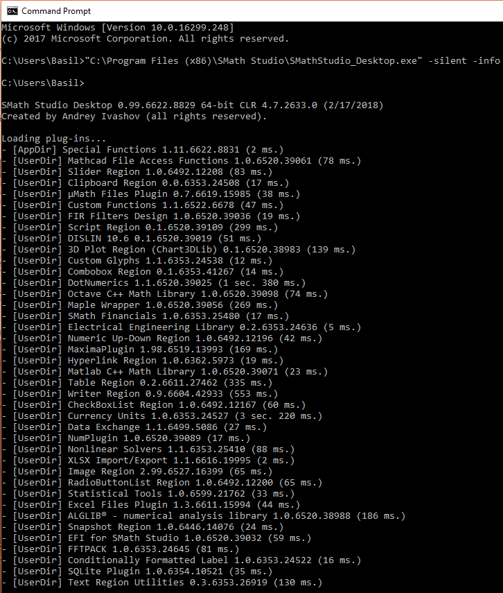

#12 Опубликовано: 19.02.2018 14:46:31
Not sure, but may be this is because of sort order of plug-ins or some additional plug-in which breaks the logic...
Please could you execute the following in command line? (path to SMathStudio_Desktop.exe may differ on your PC)
"C:\Program Files (x86)\SMath Studio\SMathStudio_Desktop.exe" -silent -info
I would like to see the output of this command in order to try to reproduce this on my environment.

#13 Опубликовано: 19.02.2018 22:09:18
Basile
Basile

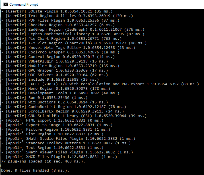

SMath-05.PNGHere it is:
#14 Опубликовано: 19.02.2018 22:11:22
Basile
Basile
#15 Опубликовано: 21.02.2018 03:59:05
Thank you very much! Now I have everything to try reproducing this issue.
