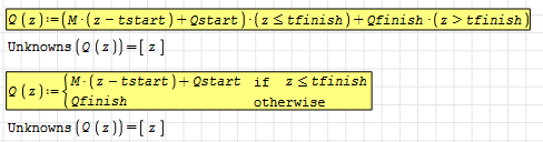

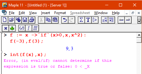

Yes, it's a known issue, but not just in SMath, except that in other languages there are tools to handle 'piecewise continuous' functions. In maple, for example, you have the piecewise function, similar to SMath's cases, but also the much more powerful Heaviside, which is actually not a function, but a distribution (and not in the sense of probabilities, but as limit of sequences of functions)
To help understand more or less why some functions can be integrated and others can't, or be used for solve or roots, they are only candidates if the Unknowns function does not return an error and can detect its variables.
FUNCTION INTEGRATION PROBLEMS (uni) with Unknowns.sm (20,18 КиБ) скачан 1317 раз(а).

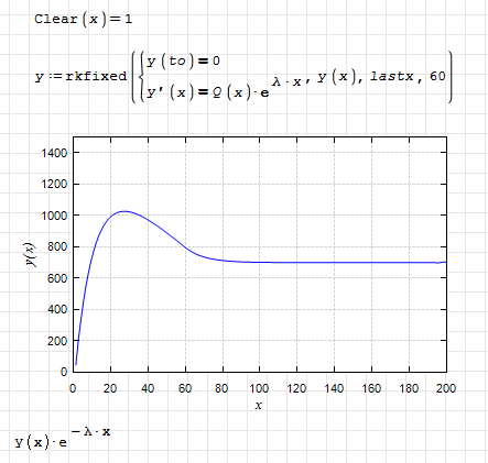

I suspect using 'if' function within Q(z) will not work for similar reason it did not work in these examples: https://en.smath.com/forum/yaf_postsm81767_Issues-with-cases-if-and-error.aspx#post81767
