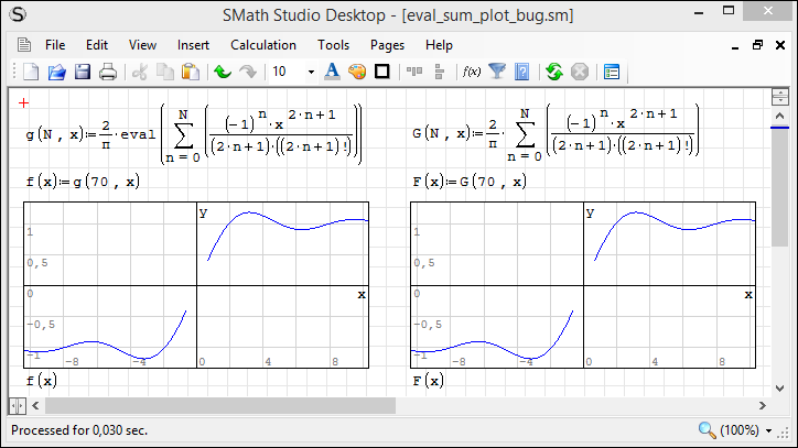

Jean,
Thank you! Fixed. And... if previous versions of SMath Studio required eval() function to be used, now it doesn't matter anymore.
eval_sum_plot_bug.sm (7,14 КиБ) скачан 1324 раз(а).
