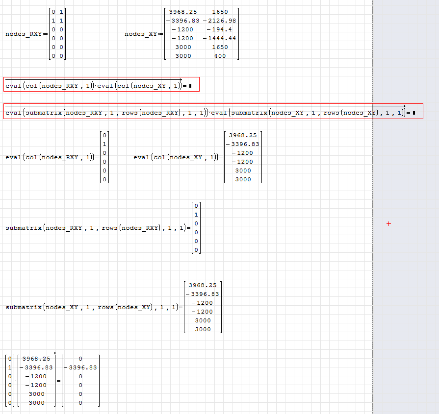

sergio 09.03.2016 06:05:00
#23 Опубликовано: 09.03.2016 03:14:21
What do you think Andrey to put then invert() function as well in the exception?
Function transpose() will get into the operator but invert() will not. Therefore, there is quite a difference between rising a matrix to a negative power inside vectorize() and having invert() inside vectorize(). For example, we have abs() and det() but inside vectorize() there is visually no difference.
I also hope this will not open some other issues regarding the vectorize() function.

#24 Опубликовано: 09.03.2016 03:35:36
Quite right Radovan,
That will require a "task force" checking wrt Mathcad.
The collection of vectorise is huge ! and would be
partial wrt functions not implemented in Smath. In the
mean time, the options in the previously attached
work sheets are VISIBLE. The risk of conflict between
"conventions" and "inventions" is silent/present.
Remember the Smath missing col operator <,> ... +++

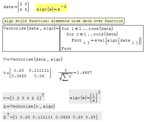

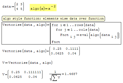

Jean,
thanks a lot for sharing ...your approach with the algo technique of passing a function ..to a function is very interesting .
It is something I had never thought that was possible to do, it is very elegant and concise.
Thanks again and best regards
Franco

First of all - thank you, Andrey, vectorize() can be EXTREMELY useful.
My vote goes for creating no exceptions. Its way easier for end user to understand why vectorize() throws an error (inverse of zero for example), rather than understanding why one "exception" works but not another.
A logically valid workaround is use of eval() inside vectorize - it just makes sense, easy to document and achieves the end goal.
If anything we could use a symbolic alternative of eval() (or does it already exist)?
Cheers All
Davide Carpi 09.03.2016 13:20:00

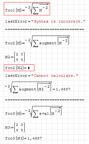

I'm not sure if this had been asked:
Currently, it's impossible to create a function like
f(M)=sum(M)
because sum takes only matrices, and M here is unknown type.
Using, say, augment(), which return type is known to be a matrix, I can do this:
f(M)=sum(augment(M))
I cannot use vectorize(), because its return type may be scalar like in vectorize(1), or system.
Though I can use it with eval().
The question is, is it possible to make vectorize always return matrix? When argument is a operation on system, for example, the result type differs from input. Having this could allow for such constructs without evals.
Or maybe allow sum to accept any type of input, making it return input itself if it's scalar/system/string?

It is unfortunate that eval() prevents vectorize() from evaluating its arguments one-by-one.
For example:
f(x):=(1/x)^2
vectorize(mat(1,2,3,4,2,2))=mat(1,0.25,0.1111,0.0625,2,2)
f(x):eval((1/x)^2)
vectorize(mat(1,2,3,4,2,2))=mat(5.5,-2.5,-3.75,1.75,2,2)
If the expression of vectorize is optimized before by-element evaluation, then it's impossible to use, say, linterp() in such functions, and eval doesn't help.
С уважением, Михаил Каганский

#38 Опубликовано: 22.03.2016 16:07:26
I'm trying to replace a number of loops in my files that are used to fill matrices, with a cleaner syntax of vectorise. And I meet with some limitation that MAY be curable if Andrey decides that it's possible (and that's not too difficult taking into account his code).
Specifically, I attach a file that I tried to cleanup today. One of loops is marked by magenta. It's impossible to rephrase it like is shown to the right of it on margin (highlighted by red), though both Q and t are vectors that I want to be used one-by-one, to get resulting vector of formula results. The problem is that the functions that are used in my top-most function use *interp() on some other matrices, and that makes this syntax illegal. I dream of a proposed here "novectorize" or suchlike...
In the attached, your clean creation of dual vector is suggested. You could probably work a long route by creating the model of T, P data set. By inspection it looks simple polynomial fit. Seeing
ΔP make me think your are trying to compute some MassFlow in association with m^3. You may not have
the appropriate formulation ... which is in construction in my design board, maybe a day or two.
On the other hand ΔP.доЦТП:vectorize(Δp(Q,D,L,Δ.э,t)) is not a function definition.
If I'm correct assuming you try to compute MassFlow, better start working unitless to ease reading.
Regulirujushchijj klapan Notes.sm (292,54 КиБ) скачан 1552 раз(а).
#39 Опубликовано: 22.03.2016 19:44:54
About foo1 and foo2 you can avoid the evaluation on assignment using a programming function (line()); no ways to use vectorize on linterp
foo.sm (20,62 КиБ) скачан 1548 раз(а).
Any further improvement on vectorize is welcome from my side
Mike Kaganski 22.03.2016 20:12:00

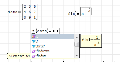

#40 Опубликовано: 30.03.2016 12:13:03
Ruben Sidranski
Ruben Sidranski
The problem is that "vectorize" is not passed through with the function definition
You will notice that the vectorization "arrow" is missing in the definition of f
