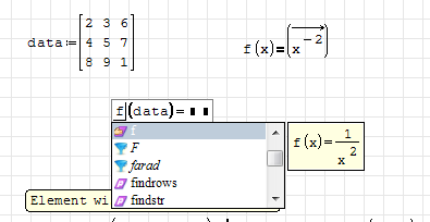

Hello Andrey!
recently i found out about an issue with the Viewer, might it be possible to fix the update proces while using plugins like the comboboxList?
Please see the example pictures and you see the posibilities of the second list don't change
with the selection made in the first one, wich is non of a problem using
the file with SMath Studio... only with the Viewer it fails.
Thanks a lot for concerning!
I'd appreciate your help very much!

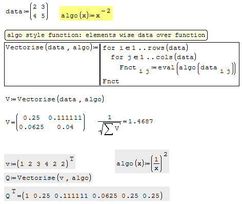

Sergio,
Your example that works elements wise, check for other issue:
vectorise as you did ... SQRT( ... result at the bottom of
the attached work sheet in light red.
Utilities Matrix Vectorise EXPRESS.sm (56.49 KiB) downloaded 1506 time(s).

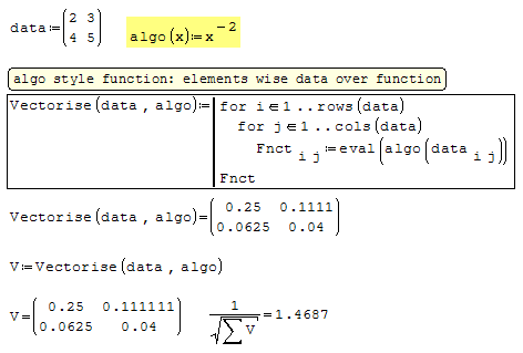

Jean,
thanks a lot for sharing ...your approach with the algo technique of passing a function ..to a function is very interesting .
It is something I had never thought that was possible to do, it is very elegant and concise.
Thanks again and best regards
Franco

Hello, Sergio.
[albumimg]1430[/albumimg]
Thank you for pointing it out.
From programmers point of view everything goes correctly here. You tries to transpose every single element of matrix, which is not allowed by the program (as transpose operation can be applied for matrices and vectors only). But on other side I see it will be very handy to have transpose operation in some exceptions list for vectorization.
Will check what I can do...
Best regards, Andrey Ivashov.

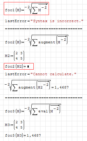

I'm not sure if this had been asked:
Currently, it's impossible to create a function like
f(M)=sum(M)
because sum takes only matrices, and M here is unknown type.
Using, say, augment(), which return type is known to be a matrix, I can do this:
f(M)=sum(augment(M))
I cannot use vectorize(), because its return type may be scalar like in vectorize(1), or system.
Though I can use it with eval().
The question is, is it possible to make vectorize always return matrix? When argument is a operation on system, for example, the result type differs from input. Having this could allow for such constructs without evals.
Or maybe allow sum to accept any type of input, making it return input itself if it's scalar/system/string?

It is unfortunate that eval() prevents vectorize() from evaluating its arguments one-by-one.
For example:
f(x):=(1/x)^2
vectorize(mat(1,2,3,4,2,2))=mat(1,0.25,0.1111,0.0625,2,2)
f(x):eval((1/x)^2)
vectorize(mat(1,2,3,4,2,2))=mat(5.5,-2.5,-3.75,1.75,2,2)
If the expression of vectorize is optimized before by-element evaluation, then it's impossible to use, say, linterp() in such functions, and eval doesn't help.
С уважением, Михаил Каганский
