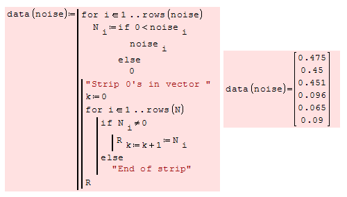

Pretty simple to zap negative values:
1. transform negatives to '0'
2. strip vector from '0'
No need using Smath Viewer.
Cheers ... Jean.
Random [rnd(n)] Filter.sm (10,03 КиБ) скачан 1055 раз(а).
Composite clean negatives.
