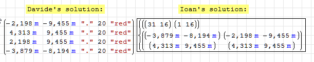

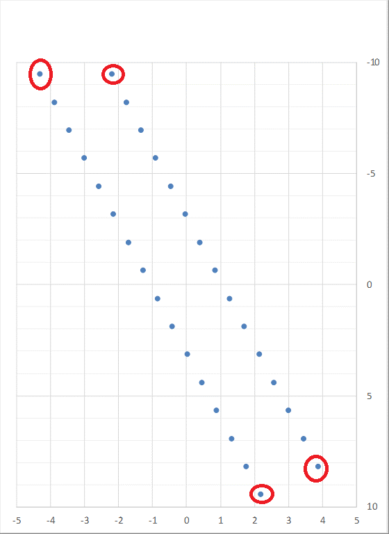

#6 Опубликовано: 29.02.2016 16:28:56
Alexander O. Melnik
Alexander O. Melnik
@Davide,
Very interesting your solution.
But in fact your solution gives almost the same results as mine's - one position exception:
Now, it's Alex's turn to use or to unvalidate.
Best Regards,
Ioan
