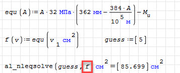

#3 Опубликовано: 25.04.2022 08:22:41
This works too: al_nleqsolve(guess,f)

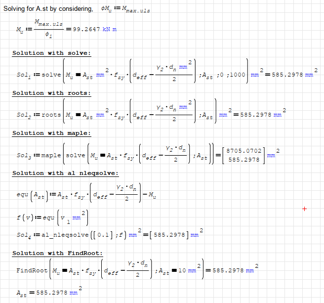

#6 Опубликовано: 25.04.2022 10:17:41
Here is your file solved with various solvers.
I also corrected your formula depending on your first question.
d.eff is multiplied in your file, subtraction occurs at first post.
solve() can solve between -20,20 range as default.
If your result shall be out of this bound, you will need to specify it.
Or you can change your default roots range from Tools>Options>Calculations.
FindRoot() can also solve equations with units as maple-solve.
Just give it a boolean guess to start calculation with.
Be careful, it will assign your unknown with result.
ASSINGMENT_1_result.sm (1014,05 КиБ) скачан 1729 раз(а).

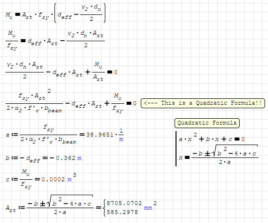

You can also solve your problem with quadratic formula.
And here is your one-line algebraic solution.
It is derived from quadratic formula.
Numeric solvers not involved.
