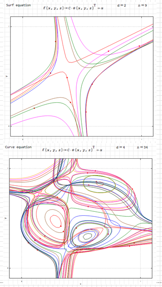

See please Ellipse-Hyperbola.sm (11,37 КиБ) скачан 1470 раз(а).
But cannot plot cubic lines.
Cubica.sm (29,75 КиБ) скачан 1476 раз(а).
Is it my or SMath error?

WroteHi Vladimir. The problem is the poor quality of SMath's numerical code for linear algebra. A workaround is to redefine the determinant using some plugin.

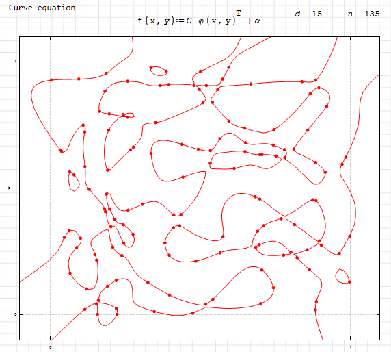

Yes, that's the sequence. It is the number of coefficients that have a homogenous bilinear form in two variables. And is the number of rows in the matrix 'v' in the file.

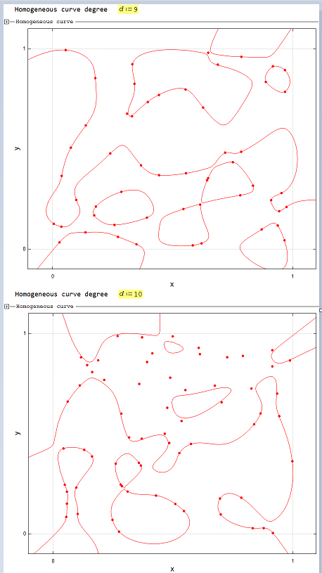

WroteLimit at n=10
I put the comments backwards. For big n, disable the SMath matrix inverse method and use dn_LinAlgSolve.
Homogeneous Curve.sm (31,07 КиБ) скачан 1395 раз(а).
