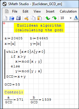

An example of finding the greatest common divisor (gcd) in SMath Studio. This demonstrate functions: while, if and line.
(download an example)

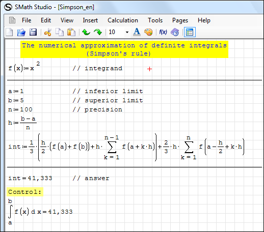

Using of Simpson's rule with built-in SMath Studio functions. Example demonstrates work with user-defined parameters, functions and built-in function sum.
(download an exmple)

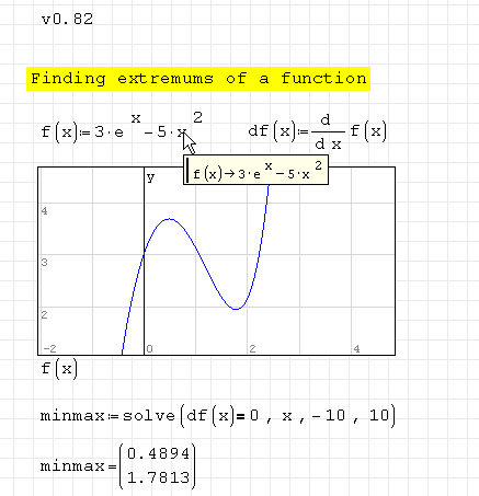

#4 Опубликовано: 06.07.2009 14:55:10
An example of finding function extremum (minima, maxima)
(dowload the file)
It is advisable to put the mouse on the expression because during the editing SMath sometimes does not understand what we wanted to do, for instance
It looks the same, but it is not the same function. If this is the case just type the equation again until you get what you wanted.
