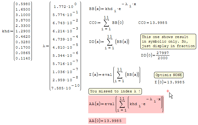

Looks like a bug. If you right click DD(0), and change the optimization to symbolic, it gives the right answer.

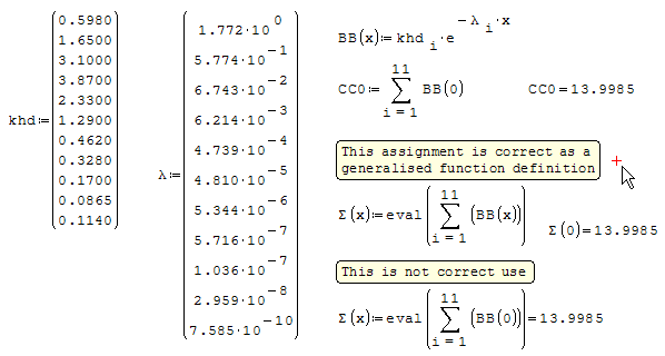

Define as a function of an argument and use eval(,)
Thank you Jean, it is great hint for me.
I've tried to use 'eval' function for the output of summation function as like you.
But I got another results.(See attached sample file)

You forgot to index λ
Dear Jean,
Thank you very much for kind correction!
Your timely comments enlightened me in the darkness!!
