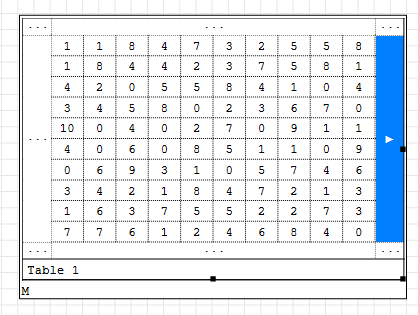

Hi. I guess that the effort less way is putting the matrix into a Table region, and using the 8 three dots that appear at borders and edges for navigating in the matrix.

I like the idea of tables; however, as far as I can tell, it will not do continuous scrolling. Maybe I am missing something.

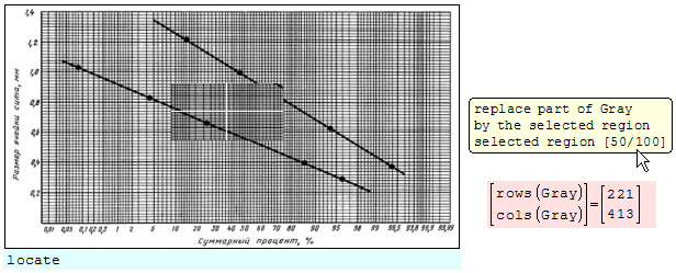

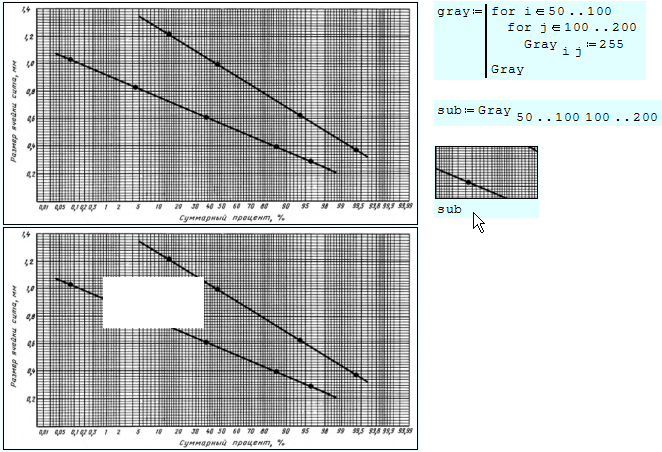

Simply a bit more descriptive, cross hair helper from Padding the region
Padding is what we use to zoom Fourier a gray or RGB image, up to zoom 2.
For larger zoom, I use IrfanView or WinGrab.
Cheers ... Jean. Take Care.
Image Matrix Scroll Region Copy.sm (3,88 МиБ) скачан 1408 раз(а).
You are not missing anything.
There is no continuous scroll for table region.
