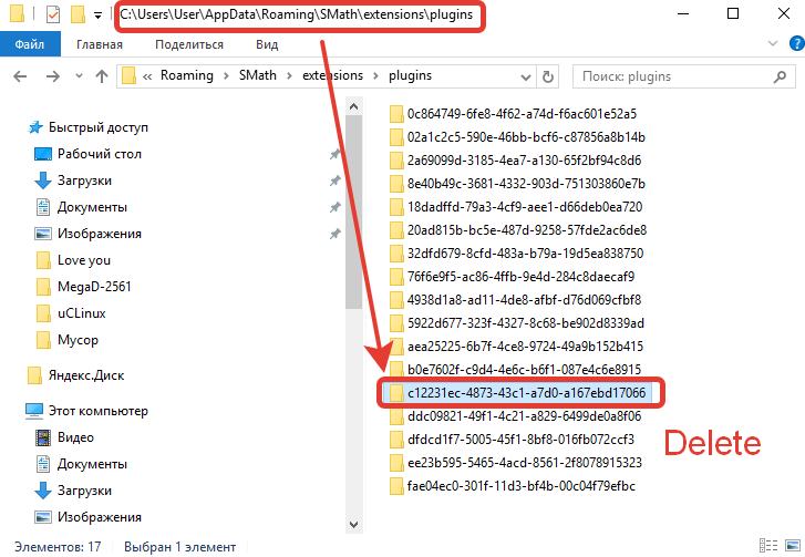

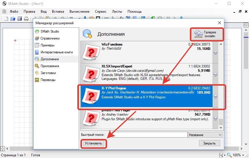

When I try to load one of the files at:
https://en.smath.info/forum/yaf_postst1774_X-Y-Plot-Region.aspx
I get the message that XY Plot Region Plugin must be installed and I load it. I then get the message that the the file is already loaded. When I look at the list of installed plugins, XY Plot Region is not installed and I cannot find reference to a file for it on my entire computer, and no reference in the registry.
Does anyone have a suggestion on how to completely remove it so I don't get the message it is already installed or to make it 'visible' to SMath?
I've tried numerous approaches and have uninstalled and re-installed SMath 3 times now in an attempt to start with a 'clean' system.
All of the example files have unresolved references.
Dik
#2 Опубликовано: 17.09.2018 20:36:46
1 542 сообщений из 1 857 понравились пользователям.
Install.
