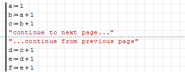

I have scoured the forums and googled this but not found an answer yet.
Thanks
![2014-03-06 15_26_41-SMath Studio Desktop - [Page1_].png](/ru-RU/files/Download/e2SdNH/2014-03-06-15_26_41-SMath-Studio-Desktop---[Page1_].png)
