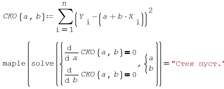

#1 Опубликовано: 08.07.2023 12:36:53
Valery Ochkov
Valery Ochkov
67 сообщений из 708 понравились пользователям.
3-5.sm (3,97 КиБ) скачан 1306 раз(а).

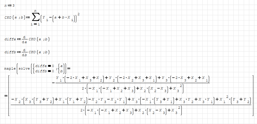

#2 Опубликовано: 08.07.2023 13:01:36
Derivatives mostly doesn't get along with solvers.
And you really need an n value to make this work.
Valery Ochkov 08.07.2023 13:09:00

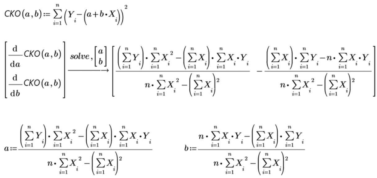

#3 Опубликовано: 08.07.2023 13:10:17
Valery Ochkov
Valery Ochkov
Thanks.
But I was waiting as in Mathcad

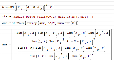

#4 Опубликовано: 09.07.2023 01:42:37
Hi. This is a way.
linregress.sm (17,05 КиБ) скачан 1312 раз(а).
linregress.pdf (85,29 КиБ) скачан 1033 раз(а).

#5 Опубликовано: 09.07.2023 03:54:15
Valery Ochkov
Valery Ochkov
Hi. This is a way.
Thanks!
But what is it?
1 C:=Sum...
2 ans:=...
#6 Опубликовано: 09.07.2023 04:47:30
Thanks!
But what is it?
1 C:=Sum...
2 ans:=...
It's a maple component from the maple tools plugin. You must to have it at the insert menu:
#7 Опубликовано: 09.07.2023 23:18:19
This is a way that avoids using the component and uses the maple function
Valery Ochkov 10.07.2023 02:05:00
