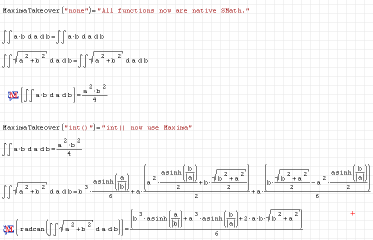

#9 Опубликовано: 02.10.2014 18:37:24
This is what Maxima does.
Edit: the second integral can be simplified using one of the many Maxima simplification functions.
