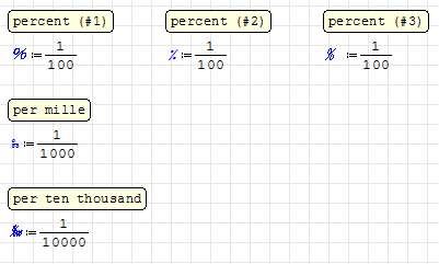

An old personal snippet, revisited.
snippet shortcut: percent

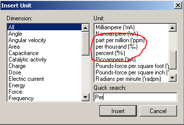

Simply great! I tried that and did not find appropriate characters.
If you want to have these units built-in, then replace the file units.xml in subdirectory "entries" of your smath installation.

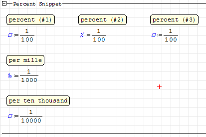

@Davide
Some of the unicode symbols don't show up correctly in my installation (mkraska portable version). See picture.

Seem that your "courier new" font is not updated...
Try looking here and here (with the same machine) if you have the same issue.
