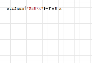

You can use importData.XLSX from Xlsx Import/Export plugin

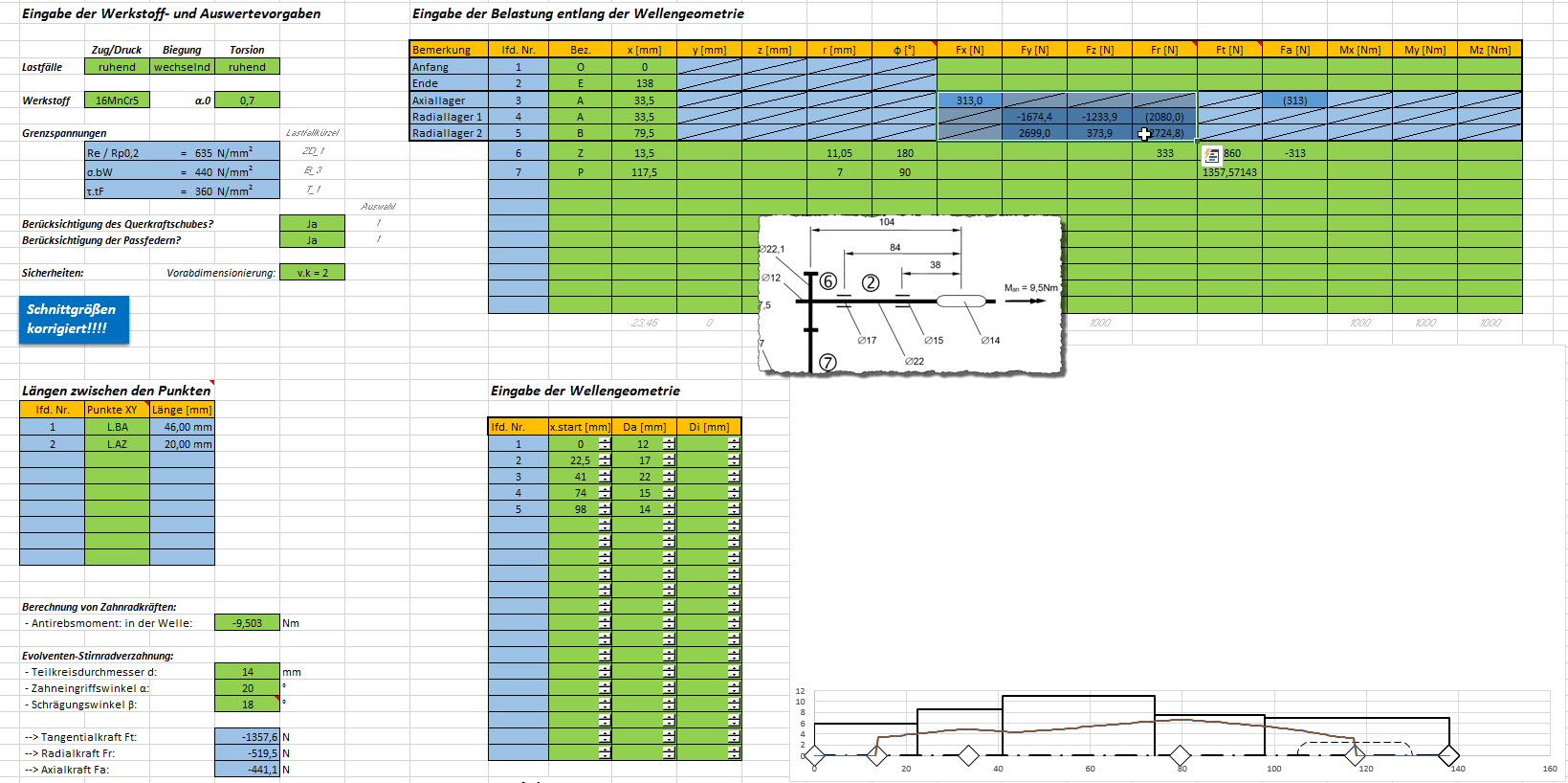

So here what it is all about:

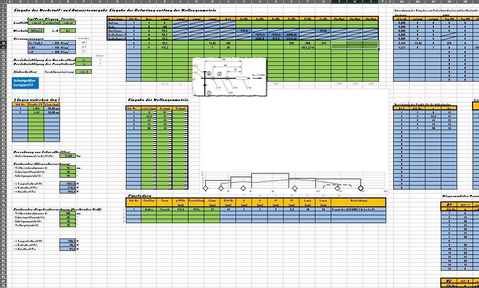

I've created a Excel-file with many different sheets within to do the following:
-1- define the input-values like
+ setcions of a shaft (diameter, length)
+ material paramters (mechanical stiffness parameters)
+ the points where loads are aplied to the shaft as well as the mounting points
-2- the sheet is built up in the way that the reaction forces at the mounting points are calculated automatically by value (not by formula)
-3- on another sheet ...
+ the internal force variables
+ the single mechanical stresses (like tensile stress / pressure, bending stresses and torsional stress) are evaluated by combining the internal forces with the given geometry data
+ the reliability is determined from the given stresses and the material parameters
All this is calculated by value (not by formula) in a veeeery huge table

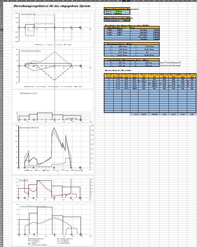

-4- the results are shown in some diagrams
Often I need to write a sample solution. For this I need to document the way how to get to the solution by formula (and not as it is done within the Excel-sheets by value only (yes there are fomulas too within the sheets but they are generated in a veeeery general way, so nothing ever any engineer would use without a computer).
For this reason there is
-5- a sheet where it is possible to generate some free punches for calculating
+ the reaction forces and
+ the internal force variablesФайл не найден.Файл не найден.

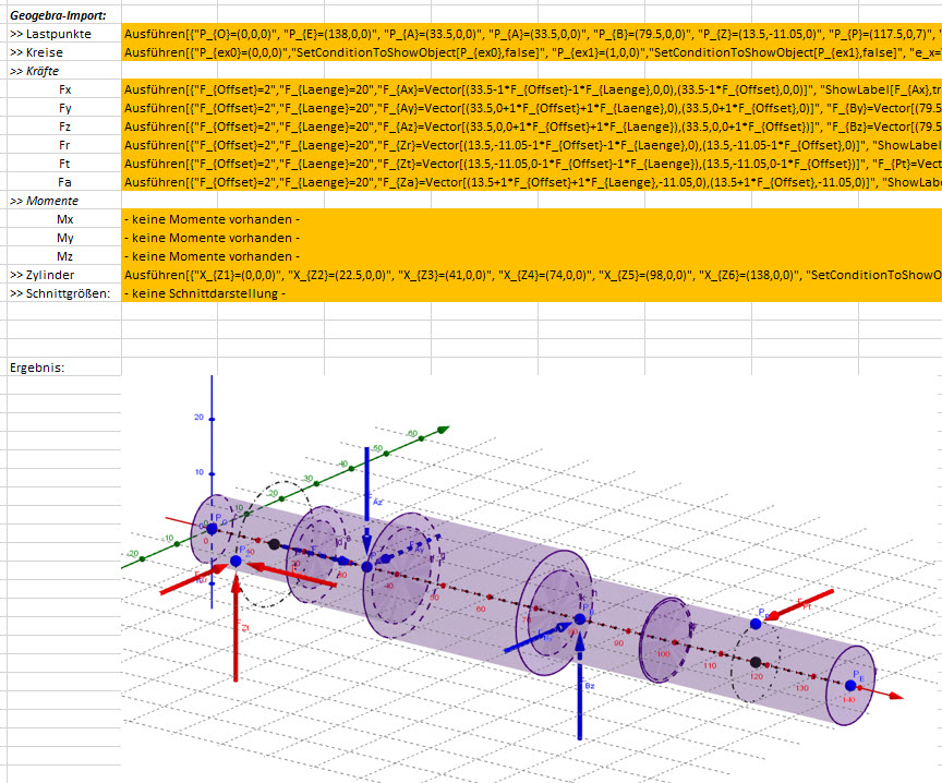

Because this is just a "static" picture [as it is not possible to build a 3D-vector-diagram wihtin Excel] I thought about using Geogebra so there is
-6- another sheet where the given model (shaft-geometry, loads, reaction forces and if needed the inernal forces) is translated into text-command-lines to be used as an input on Geoegebra's input line.

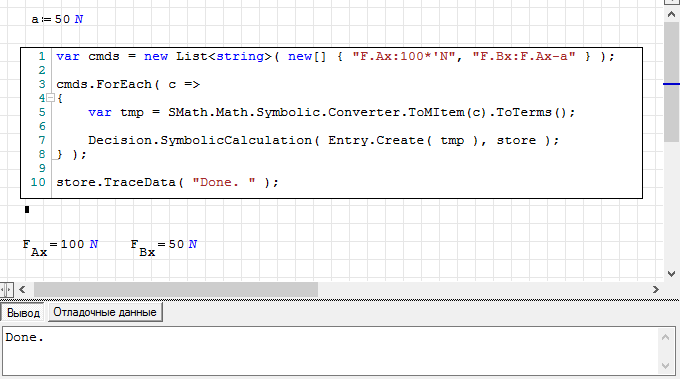

Script Region
var cmds = new List<string>( new[] { "F.Ax:100*'N", "F.Bx:F.Ax-a" } );
cmds.ForEach( c =>
var tmp = SMath.Math.Symbolic.Converter.ToMItem(c).ToTerms();
Decision.SymbolicCalculation( Entry.Create( tmp ), store );
store.TraceData( "Done." );
![2017-03-08 10-50-18 SMath Studio - [Script. Load definitions.sm ].png](/ru-RU/files/Download/XqgARy/2017-03-08-10-50-18-SMath-Studio---[Script.-Load-definitions.sm-].png)
It's funny, but I was still hoping for the sentence "You will not be able to place the expression on the sheet." not to come. But in fact thats exactly what I'm trying to do.

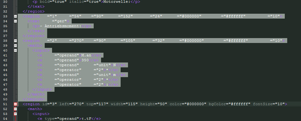

I just took a look on an example .sm-file and recognized that it is "just" a textfile, so it would be possible to "copy & paste" the body of an empty .sm-file and then insert my fomulars ....
the marked regions are going to look like that ....
As it seem to be a boring work to analyse the .sm-file and figuring out which command / region is responsible for which expression in the workbook and how its structure works:

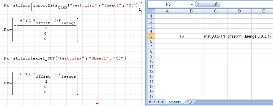

@Davide: Sorry for ignoring your former post about the inputData-plugin. According to that I've got some questions:
-1- how is the path defined for the XLSX-file (I've been trying some example where I just put both files (.sm .XLSX) within the same directory, but it doesn't work.
-2- Is it possible to "repost" the definition of a formula? When defining a formula like F.Ax:F.Bx-F.S I can see the definition (of course ;-)), but when typing F.Ax= it only shows the numerical result of the formula. I think that's the reason you've been using a matrice for importing the data, right? Is there any way torepost the definition of a formula??
Wrote@Davide: Sorry for ignoring your former post about the inputData-plugin. According to that I've got some questions:
- absolute (C:\...) or relative (in the example above, both the files were in the same folder)
- you can import definitions (simplified example in the cloud) or you can act like in the screenshot above; if you don't mind about calculations smath-side, then you can use a boolean equal in place of the definition symbol and maybe you can hide the LHS (the import function - right click on the region and unflag "display input data")

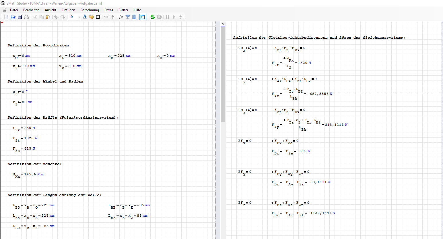

After thinking a while (and of course looking at the structure of a SMath-file) I decided that it is best for me wo export my Excel-generated data into a native SMath-file.
I know that there are easier way to solve the given problem by using so mathematics, but because I like the solution to look like it is "hand-made" it took a while in considering all those special cases that might occur. And now, after all I'm done with that and everythings works fine. So the most of the time I was spening my time in generating names for the variables, match the layout and stuff like that. Exporting and building the SMath-file was just an blink of an eys compared with that...

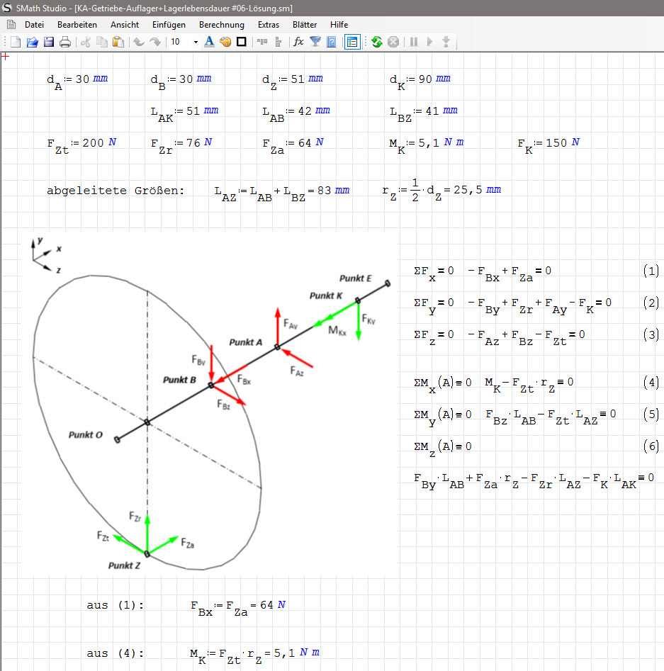

You might want to habe a look. The attached SMath-file is totally automated exported from Excel. When opening the first time you might dicover that it takes a while for SMath to build up the screen. It might be that I was not looking too seriously at the synthax-rules. But SMath is very frugal with that and if you save the file and reopen it everything is "repaired" by SMath.
Again, thanks a lot for inspiring me ;-)
here is a screenshot for those who don't like downloading the file:
here is the SMath-file for downloading:
