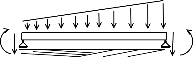

I am confident that still more than a couple engineers are seeking a simple sketch up tool for smath studio, so I would like to post a viable workaround I am using now. This workaround can become a very powerfull tool with some help from core members of this forum who know a thing or two about Smath Studio extensions.
To begin with I have to say that I have tried many ways of incorporating sketches - Using CAD and converting it to PNG, drawing in Gimp, inscape, I have even tried using Smath Modeller tool to come up with some sketches.
The solution I discovered can potentially become a great way to conviniently add a sketch to the workbook on as-you-go basis.
When you insert an "image" region in Smath it gives you an option to either import png/svg or you can double click the region to open a blank png file in windows viewer. Once you have done that in the top right corner of the viewer you can click "open" and open the file with editor of your choice (I like inkscape for making sketches). Once done editing, click save and the image will update in smath.
There is an inherent drawback of this sketching approach - png is a raster format and hence is not easily editable after creation. One can import svg file however this did not work for me (imported svg file did not show up in the image region). If one were to modify / create new "image" region where default imbedded file is svg that can be opened when double clicked, an inkscape (or other vector editing software) can be used to create and later modify sketches of any complexity.
What do you guys think?

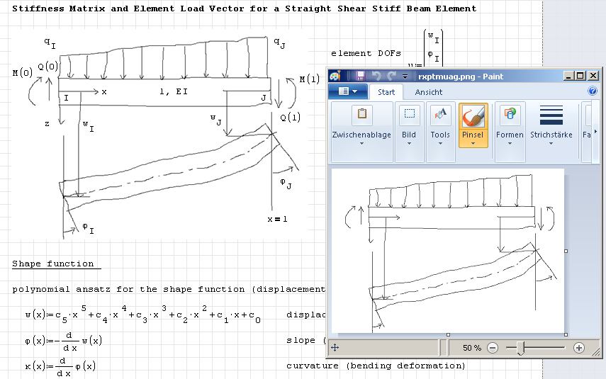

What you discovered is exactly the intended use of the edit feature added by Kay Graubmann to the image region, see the announcement. It is somewhat hidden in the interactive book (under [?]> Plugins> Image Region, please ignore the error message, in the current version there is an image file missing, I fixed that in SVN now)
I understand you have the feature request to be able to set the image format prior to open the editor. This should be quite straighforward, although currently we cannot rely on Kay implementing this.
The initial choice for png was due to the availability of a slim png editor under Windows (paint). For svg images, I tried inkscape, which takes quite a while to open, thus it is not exactly quick sketching. I just was happy to avoid the "no erase" picture region for sketches.
BTW, I use math regions for labeling the sketches, see attachment.
As for the svg-problems, could you please file a bug report in the bug tracking system with the sm-file and the offending image file. If you are not sure if it is really a bug, you might post it first in the image region topic.

I most definitely missed the announcement for the region (was not using Smath than). On a bright side this thread is the first thing that comes up when you search for Smath and sketching so I am sure someone will find this info useful.
Anyway for creating svg (and in particular making sketches) software "Dia" is pretty great - it comes with many embedded shapes/objects, opens very fast and can export to svg. It can open svg files as well however its native format is .dia. This sketch took less than a minute to produce and can be edited later on in "Dia".
LibreOffice Draw is also very quick and quite powerfull once you enable all the toolbars you need. It also works very well with svg format. It would be great if there was an easy way to choose either png or svg format for this region as an empty drawing.

Thanks for the hint. I had a look at Dia. Not bad, main drawback is that this would not just be a new file format but the image region also would have to make Dia export the image to some graphics format for display in the document.
I use TpX/Latex if high quality labels are required. It saves the image as latex snippet. This approach requires a working latex installation and would create another external dependency.
