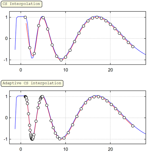

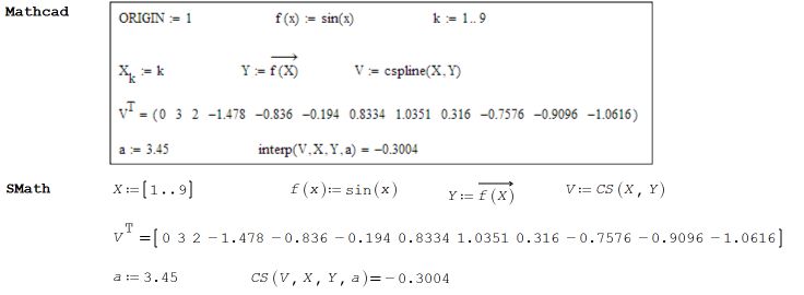

#6 Опубликовано: 29.08.2018 02:49:38
Hi Jean. There are not to much shadow in that small code. It's just the implementation of the traditional spline interpolation. In SMath there are not, or I can't found, the function cspline. The interpolation with cinterp in SMath evaluates the vector V each time that you call it, it's always better to have V=cspline(X,Y) and then call interp(V,X,Y,x). Finally, I want to implement an adaptive step size for the intervals in X. But first I see very convenient to have vectorization and plotting issues solved.
CS only do what mathcad's cspline do:
#7 Опубликовано: 29.08.2018 16:16:49
CS only does what Mathcad's cspline does:
1. You have a good point, but invalid: cinterp(X,Y,x) works faster than Mathcad [I tested long time ago].

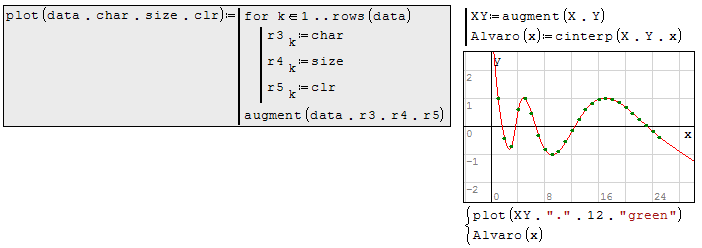

#8 Опубликовано: 31.08.2018 01:21:49
CSplines with adaptive steps. Same issues, but now can use zero with units, at least in the adaptive case.
adapt cspline test.sm (83,25 КиБ) скачан 1330 раз(а).

#10 Опубликовано: 31.08.2018 13:29:14
I will add this as well, if you do not mind.
Two of the main reasons we want to use interpolation (cinterp f.e.).
I think I mentioned this many times...
4. numerical derivation ... left unsolved
5. numerical integration =
Numerical derivation from the Smath d/dx is not possible ... WHY ?
The derivative operator derives wrt to rules that apply to function(s)
cinterp(X,Y,x) is not a function, only an interpolating function.
Alternately two ways:
1. from the dspline(s,X,Y,t) ... 's' from solving
2. from the infinitesimal D1(x,h,f) ... where 'f' is cinterp(X,Y,x)
Exemplified in the attached ... Jean

#14 Опубликовано: 06.12.2021 03:21:27
Updated (Now it works again). Revised because the new develop of interpolation funcitons by Viacheslav at https://en.smath.com/forum/yaf_postsm75020_ODE-Solvers.aspx#post75020
This worksheet is about adaptive csplines and differentiation and integration of the splines.
cspline.sm (106,91 КиБ) скачан 1399 раз(а).
