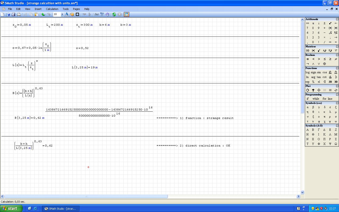

Thanks for the fast reply.
After reading the starters page, here's a screenshot :
As you see :
1st result : 0.62*'m^{{16386721669152500000000000000000-1638672166915250*10^16}/{5000000000000000*10^16}}
(which actually is similar to 0.62 m^0 = 0.62)
2nd result : 0.62 which is correct.
As you see :

Hello housen,
If the result looks like this as it was by calling function B(z), then there is likely to be connected with the symbolic processor of SMath.
Just select the definition of function B(z), then right click and choose Optimization|Numeric, or choose from the menu Calculation|Optimization|Numeric. After that you will have by calling the B(z)=>
B(3,25m)=0.62
B(3,25m)=0.62
