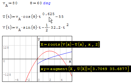

Good afternoon everyone.
I'm using the "roots" command, but I'm not getting the two points where the line intersects the parabola. The command gives me only one result and omits the other point. Attached is the file and image of the problem. How can I find both intersection points?

#2 Опубликовано: 14.04.2023 17:35:21
As doctored ... Jean

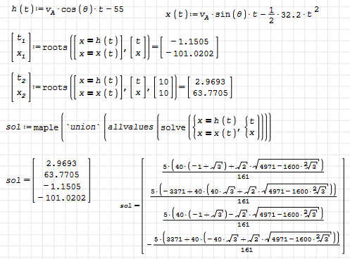

#3 Опубликовано: 14.04.2023 18:41:21
Hi Sergio. There are a 3 argument version of roots, where the third is a guess value for the root.

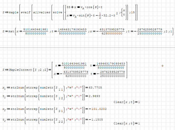

Here your solution solved with maple plugin.
No need to enter guess points for this.
Maxima can solve it too, similarly.
PS: MapleCorrect() function can be found here.
Assign() function can be used instead of str2num() + num2str() + strrep().

#7 Опубликовано: 16.04.2023 02:49:20
Hi. This is another way.

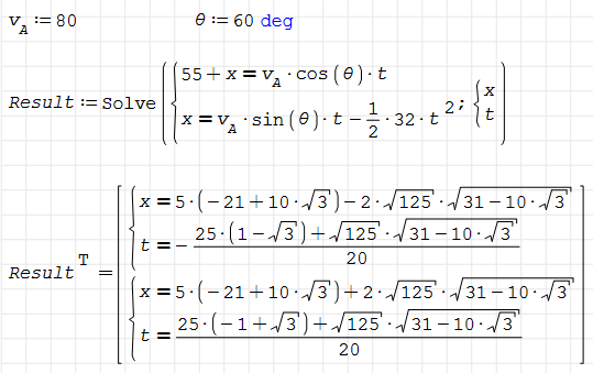

#11 Опубликовано: 17.04.2023 01:44:30
601 сообщений из 1 382 понравились пользователям.
I found a Windows laptop.
And tried Maxima plugin Solve().
It can solve easily.
Alvaro 17.04.2023 17:27:00
