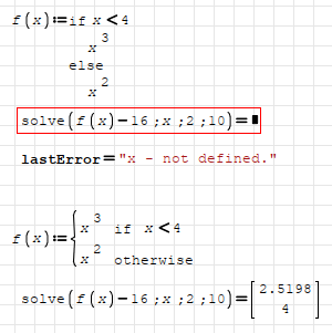

Update of statement:
solve(), roots(), FindRoot() doesn't like if() function.
However, they can solve when cases() used instead of if().

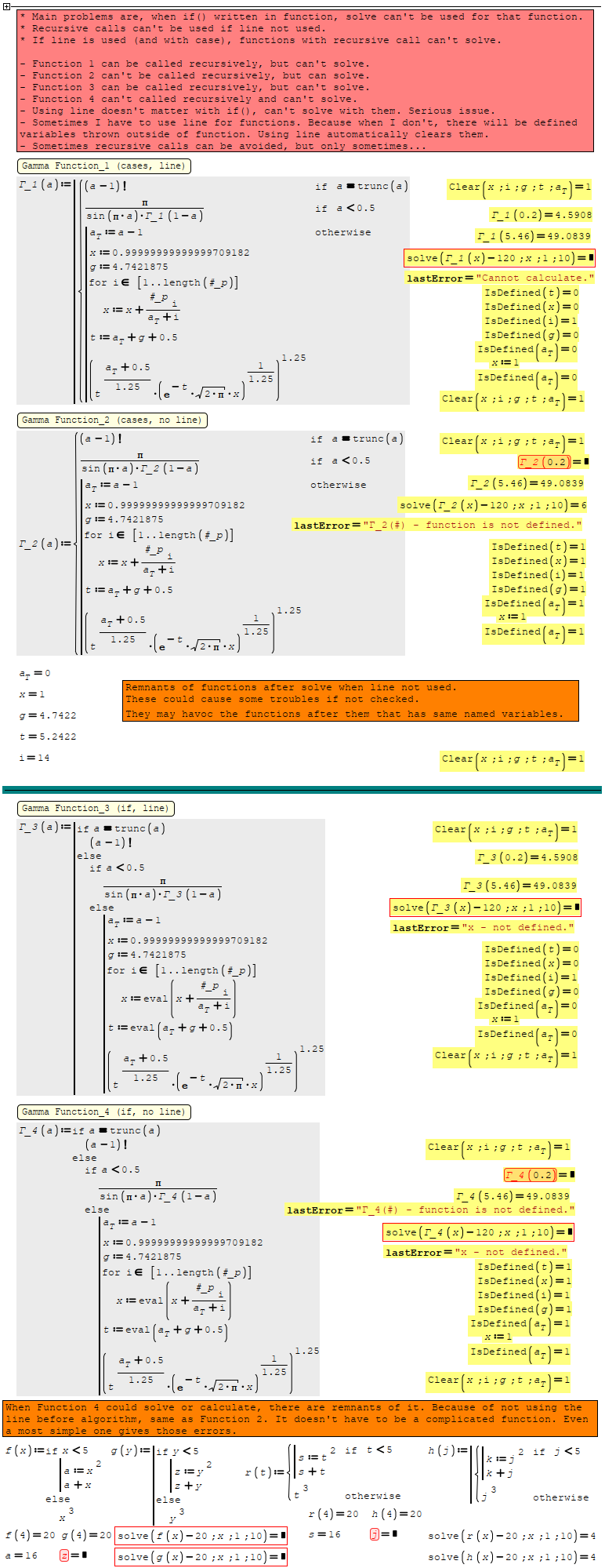

I have diagnosed the symptoms with solve bug.
Made a page about this and tried to explain with detail.
somebugs.sm (54,72 КиБ) скачан 1571 раз(а).
somebugs.pdf (522,2 КиБ) скачан 812 раз(а).
Andrey Ivashov 11.06.2021 04:06:00, NDTM Amarasekera 11.06.2021 22:44:00

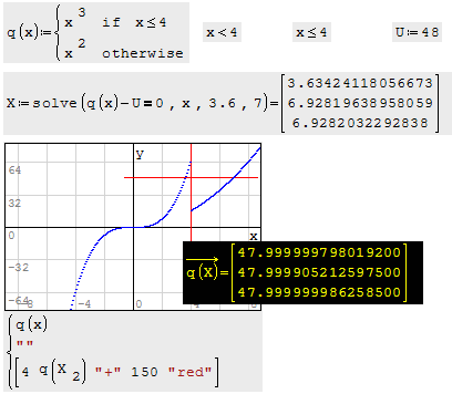

#3 Опубликовано: 11.06.2021 09:21:57
solve(), roots(), FindRoot() doesn't like if statement.
if/else was reported SS 5346.
Davide added if/otherwise SS 6179
Often, the solve bloc is ~ exact, sometimes exact
At worst 4/5 decimals.
Always start true Bolean #≤# ...
often won't complain incomplete #<#
From recollection, only DeBoor needs incomplete.

#5 Опубликовано: 12.06.2021 15:24:02
IMHO, its logical solving piece wise discontinuous,
solve piece wise as well for productive classroom.
Page3 Solve Discontinuous.sm (5,27 КиБ) скачан 1744 раз(а).

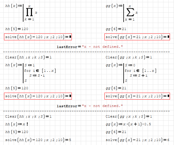

There are other bugs too.
otherbugs.sm (13,7 КиБ) скачан 1476 раз(а).
