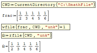

#4 Опубликовано: 04.04.2019 08:31:27
With wfile function, I am only able to get fractional representation of data available.
If the data 'frac' is long enough, Ω will show truncated
enclose [Ω]= for full length ... [,] from matrix palette 1 row, 1 col.
