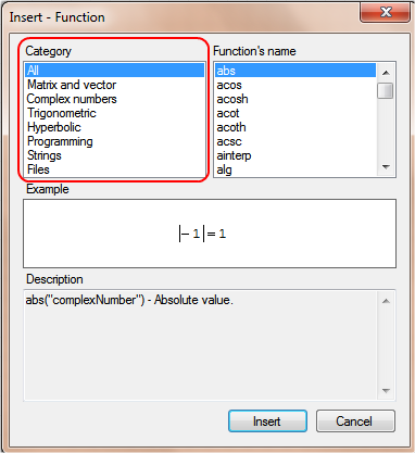

The request (already posted by some users in other sections) is to enable a way to add more categories to group functions.
best regards,
Davide
One of them could be me . The question is, how to do that? What additional categories should be made? How to manage all these things?
I think that the simplest idea is to just make a category with the same name as the plugin from which the particular function originated. This way, the name of the plugin could not be mentioned in the function description. The situation where you select a function name and do not know where from is it - is the most undesirable. Some other thing is about naming convention of the functions inside external plugins and the Andreys core functions. What about the collision between the functions of the same name like in the external plugin (I remember round() function caused trouble some time ago).
Another idea is Adnrey just simple to make additional categories, following the plugin makers request. Some of the categories, say, to be reserved for the core functions (made by Andrey) and some of them to be freely used by plugin makers. The collision between the functions of the same name still remains
Another thing is about the (non existing yet) the Help system. From the point of view of a user, I would rather appreciate when I install a plugin, at the same time to have a dedicated explanation of the plugin functions inside the Help Reference Book.
The external plugins management situation should be left to Andrey, I think. The fact is that by including additional functions and external plugins, the keeping track and to choose the desired and particular one, become quite troublesome. One other thing (which I would like to happen more often ) was the situation the two plugin makers revised the same plugin at the same time (an interesting coincidence ).
Maybe to many questions, and not so many answers, sorry.
Any other ideas?

Are exactly my thinks, and the reason because I've opened a topic instead of making a direct request to Andrey, I hope this help to choose a good way
BTW the function collision is not a problem, a Plugin developper may and should take into account the program features; f.e. a good way for a plugin developer is to uppercase the first character for his functions (f.e. Max(#) of Custom Functions and built-in max(#)). The norme(#) patch was made possible because there are no restrictions so, as for me, there's no need to have restrictions.
[EDIT] Additional catergories could be: statistical, ODE, financials, plugin (where plugin in front-end take the name from the assembly)
