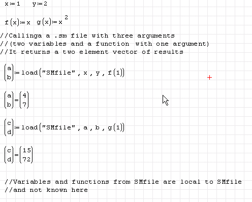

Based on the previous comments, I tried to present an oversimplified idea about how to make some kind of user defind functions. I do not know if this idea could be realised, neither if this is the optimal and right way. IMHO, from the user perspective, this might be simple enough, not including more complexity and, on the other hand, giving the avarage user the oportunity to have more flexibility and power.
Please look at the hypothetical example.
This file is using load (hypothetical) command in order to call an .sm file caled "SMfile". It passes three arguments to that file. Two variables (x,y) and a function with single argument f(1). Please look at he called .sm file.
There is, say, a protected "arg" vector. The x,y,f(1) are recognised as arg1,arg2,arg3. After tha calculation has been performed, the protected "out" vector is returned to the calling .sm file. We can call it again with another arguments. The advantage of this method is that you can write SMfile only once and use it as many times as you like, providing that the internaly defined variables and functions in the "load" file remained local, not recognised by the parrent file.
About transfering to another machine. I suppose that the mentioned idea by Will might be used here. By saving the appropriate .sm file with "load" commands, every "load" file could be saved together with it. In that case, running this file will no cause any problems on different computers. There should be also a possibility to extract and see "load" files. Moreover, parrent file with load files should be be in the same folder. There should be a mechanism which will ask the user which one to use - internaly saved or the external one with the same name. Again, more flexibility. If you just want to use the internal one, no external "load" files in the same folder as the parrent file will be present.
Making "load" files would be no problem. Any existing .sm file could be easely transformed into a possible "load" file via "arg" and "out" variables.
There is a drawback here because there might be confusing what f(1) or g(1) mean. I said that this is a function with one argument but it could also be regarded as a result from calling those functions. I have no answer here how to overcome this possible confusing.
This is just a raw idea, most likely with many shortcammings - but IMHO it is worth considering.
Radovan,
I think what you have described above would be a great and very useful implementation of custom functions.
Since you have taken it in hand to present how you would visualize the implementation of custom functions, I thought I might present what I had been thinking as well. (only as another possibility)
