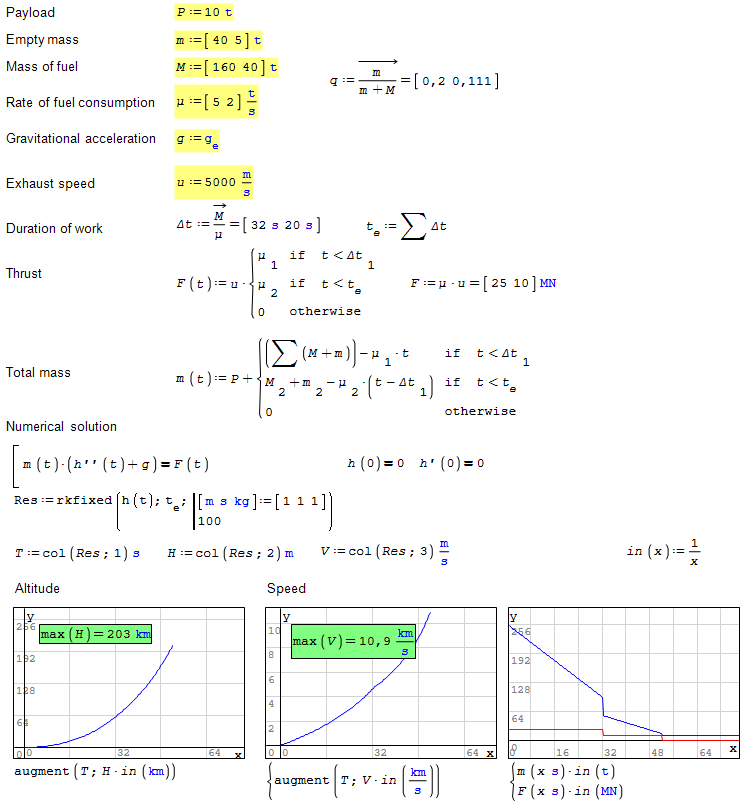

#1 Опубликовано: 14.12.2023 01:35:18

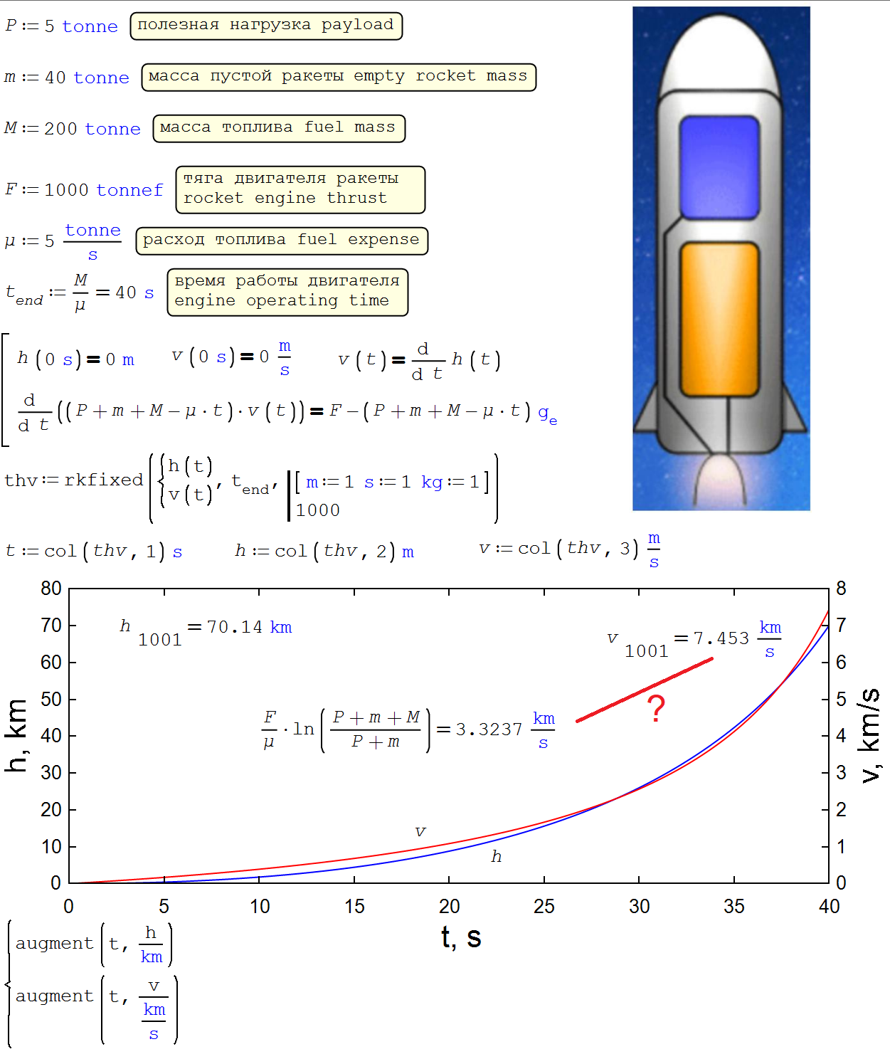

Valery Ochkov
Valery Ochkov
Here OK Rocket-1.sm (16,79 КиБ) скачан 1426 раз(а).
Here not OK Rocket-2.sm (688,11 КиБ) скачан 1457 раз(а).
About the problem Study-24-How-calculate-Rocket.doc (1,95 МиБ) скачан 845 раз(а).
from the book
https://www.routledge.com/25-Problems-for-STEM-Education/Ochkov/p/book/9780367345259

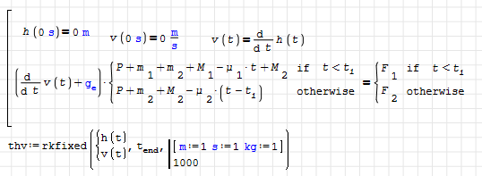

#2 Опубликовано: 14.12.2023 09:58:26

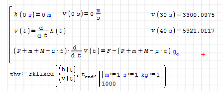

Hi Valery. Just use cases() instead if() clauses.
Rocket-2.sm (688,31 КиБ) скачан 1490 раз(а).
But Newton's second law is not F=ma which is an expression valid only for systems where m is constant. The general expression given by Newton is F=d(mv)/dt or F=dp/dt with p=mv the linear momentum.
Valery Ochkov 14.12.2023 14:13:00
#3 Опубликовано: 14.12.2023 14:30:08
Valery Ochkov
Valery Ochkov
Thanks, Alvaro!
One questions.
How can we solve this problem with ODE as F=dp/dt, not F=m dv/dt?
Will we get others (numerical) answer?
Rocket-2-otherwise.sm (690,02 КиБ) скачан 1476 раз(а).

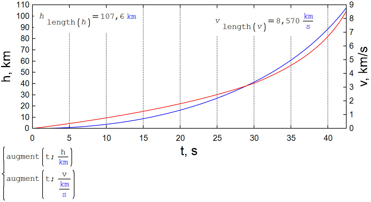

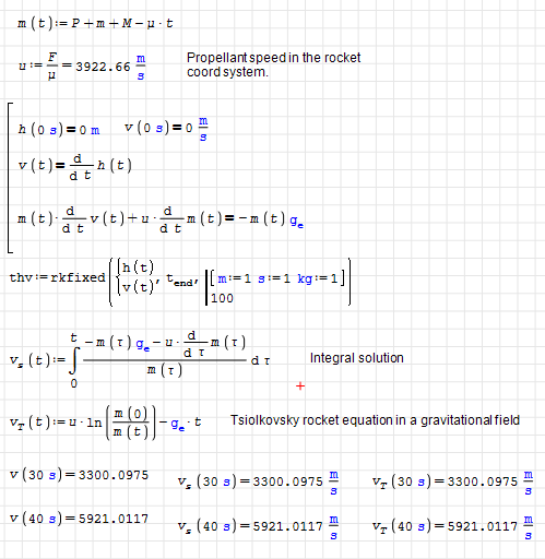

#4 Опубликовано: 14.12.2023 18:32:10

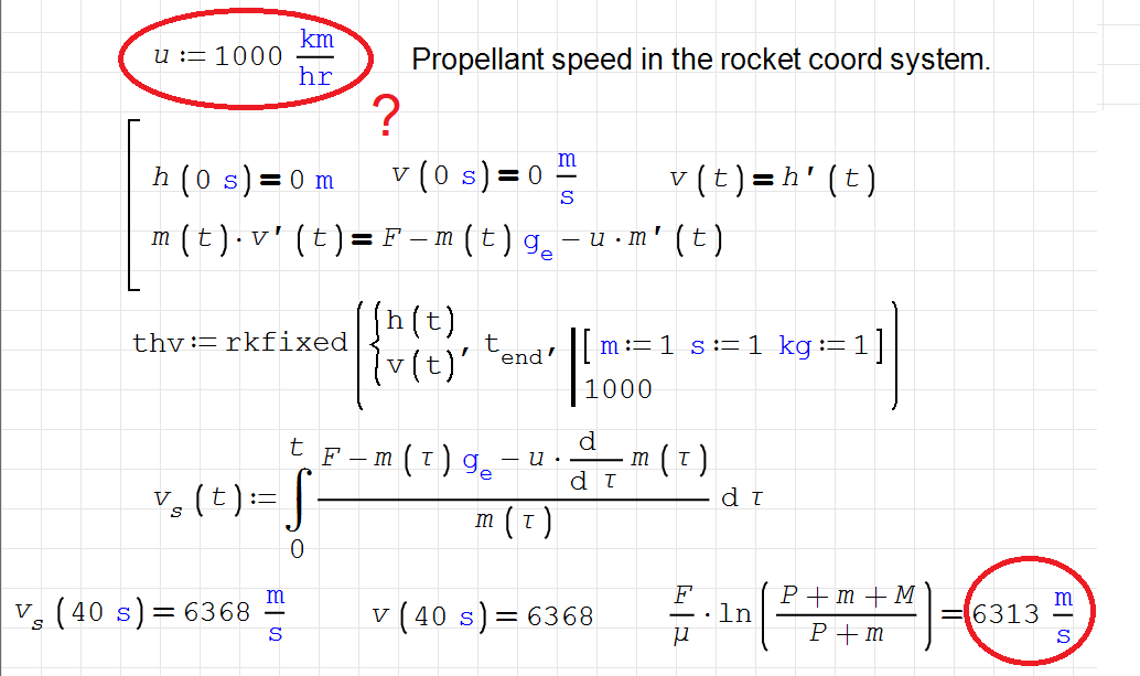

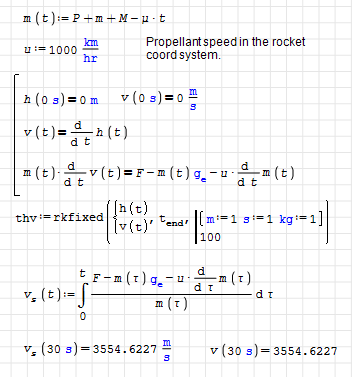

The speed of the rocket cannot be independent of the speed at which the propellant exits. Entering that information gives me this solution
Rocket-1.sm (20,07 КиБ) скачан 1432 раз(а).
Another way of looking at it, using the equation F = d(mv)/dt, we must take into account that in a rocket the reaction force is not applied to the same body as the action force, as the 3rd Law says, and therefore the temporal derivative of the product mv must be done by changing the reference frame, which is why it is F = m dv/dt + u dm/dt, where v is the speed of the rocket with respect to the inertial reference system attached to the earth, but u is the speed of the propellant with respect to the non-inertial reference system attached to the rocket

New question
Rocket-1.sm (734,95 КиБ) скачан 1477 раз(а).

#8 Опубликовано: 15.12.2023 03:25:33
Hi Valery. You're right encircling u. Its correct value is u = F/μ. Thus, the force over the rocket is F = - mg - u*dm/dt
Rocket-1.sm (23,73 КиБ) скачан 1469 раз(а).
#9 Опубликовано: 15.12.2023 04:04:15
Valery Ochkov
Valery Ochkov
Thanks, Alvaro.
And what about the 2-stage rocket?
Our first try
Rocket-2.sm (690,02 КиБ) скачан 1522 раз(а).
#10 Опубликовано: 15.12.2023 04:30:05
Our first try
Hi. Your original solution for rocket-1 is ok, and that implies that the movie's solution is also ok.
I was only pointing out the way to deduce it. Writing the relationship for several stages would imply asking for derivatives for functions with cases(), which cannot be done, because although functions can be integrated with cases() or using inside the Mathcad block, they definitely cannot be derived.
So I guess the best solution is the one you gave at the beginning, simply replacing the if() with cases(). The deduction based on physical principles has already been done for one stage. Now it remains to apply the simplified result for several, which is exactly what the rocket-2 case does.

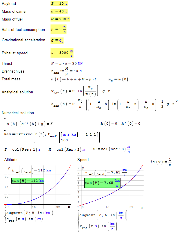

#12 Опубликовано: 15.12.2023 06:58:19
Analytical reference solution for h(t) (from a mechanics textbook) and with a single second order DE. in() would be even better without braces (operator form)
Rakete.sm (21,1 КиБ) скачан 1448 раз(а).
Rakete2.sm (21,45 КиБ) скачан 1488 раз(а).

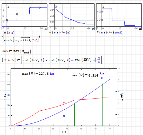

#20 Опубликовано: 18.12.2023 07:35:01

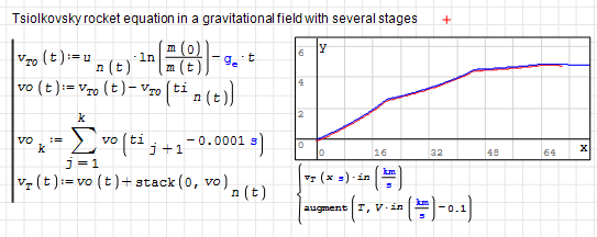

3 stages variation.
Checking with Tsiolkovsky rocket equation in a gravitational field with several stages
Rakete-3.sm (46,49 КиБ) скачан 1489 раз(а).
