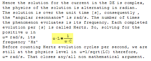

Try L[H], C[F] ... ωo=> Hz ... wrong... it should be rad/s
ωo => angular resonnance [rad/s]
You confuse yourself jumping from Wiki to Wiki
The angular Smath [Hz] unit error was reported before
[From recollection, reported by Mike].
Wikipedia is often useful, but by far not bible,
I would say "Indian telephone plagia from uneducated".
Take care Basile: Jean
