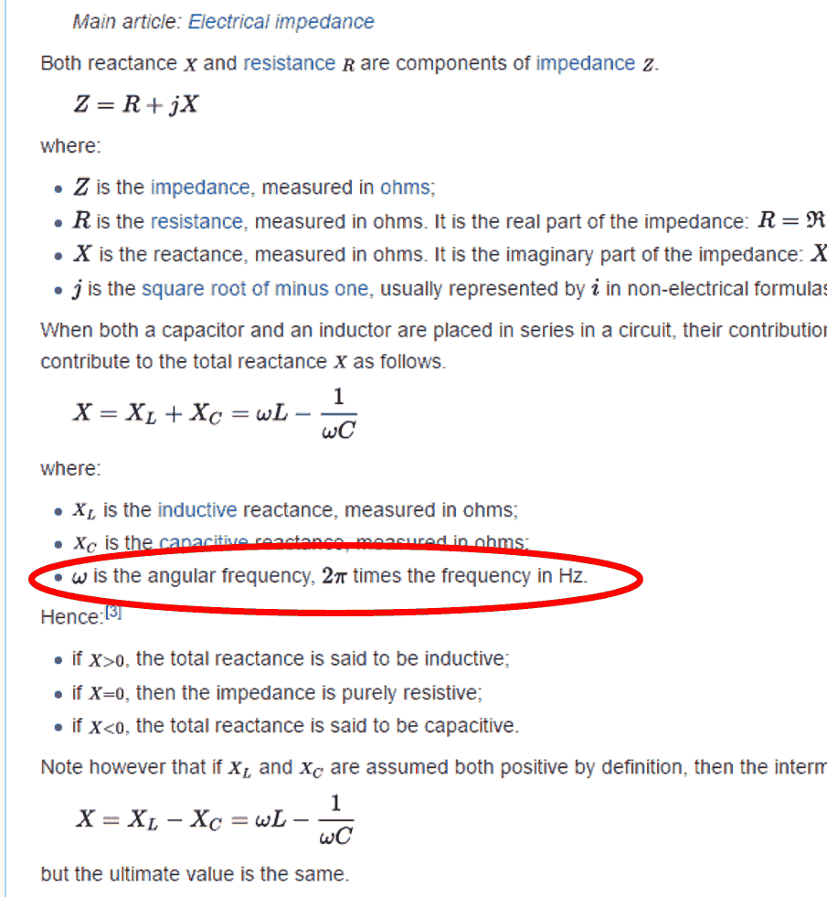

Try L[H], C[F] ... ωo=> Hz ... wrong... it should be rad/s

Wikipedia says:
https://en.wikipedia.org/wiki/Electrical_reactance
#23 Опубликовано: 28.06.2016 00:48:39
ωo => angular resonnance [rad/s]
You confuse yourself jumping from Wiki to Wiki
The angular Smath [Hz] unit error was reported before
[From recollection, reported by Mike].
Wikipedia is often useful, but by far not bible,
I would say "Indian telephone plagia from uneducated".
Take care Basile: Jean

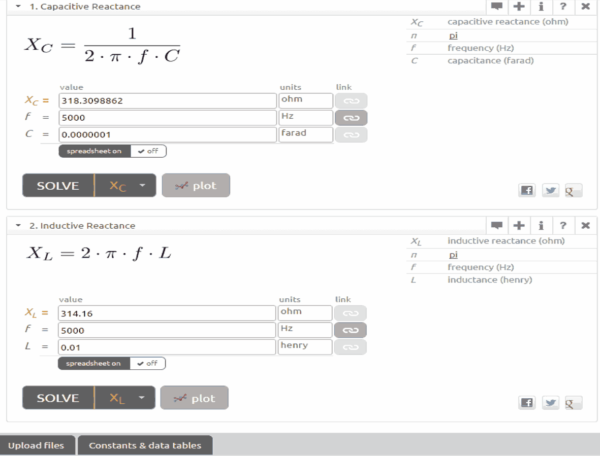

#24 Опубликовано: 28.06.2016 11:50:27
CBG
CBG
77 сообщений из 312 понравились пользователям.
I 'm not confused , you could use the units Hz . in the frequency variable .
online calculator : http://www.fxsolver.com/solve/

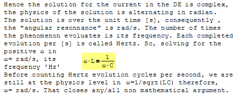

#25 Опубликовано: 28.06.2016 19:59:25
You are right: Hz is the counts/second of the evolution.
But that is not the analysis of the physics.
