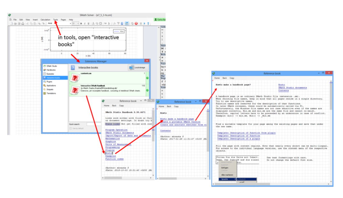

#9 Опубликовано: 25.05.2023 14:46:00
Hello Pierre,
Simply attach your *.sm document to read at opening.
Thanks, Jean.
#10 Опубликовано: 25.05.2023 15:18:09
CBG
CBG
Hello
I think the interactive book query can help you
#11 Опубликовано: 26.05.2023 04:24:31
Dear all,
I took some time rewriting the roark for Smath,
It is not finished yet, and I am still working on it on my spare time, as it improve both my understanding of smath, and structural calculation.
Many calculations can be done in other way, and if pple find a faster, or more interesting way to solve some equation/problems, i would be really interested, and integrate it.
roark v0.1.7z (1,52 МиБ) скачан 774 раз(а).
One last question:
My aim is to make an handbook, how can i perform this?
Thankyou,
Pierre
The links in your book don't work for me. It seems that batch production of links using the toolbox from the text region utilities plugin don't produce valid links any more.
So you might have to edit the xml file as I had to when I started to create the interactive handbook.
