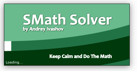

I downloaded SMath Studio AppImage from the website on ubuntu 22.04. Whenever I open it, it loads that green loading box attached below then it crashes. Any help please?. Thanks in advance

Try to run with sudo.
Whether appimage or regular, it won't run without sudo.
Well it will, but you must try a lot of times to make it run.
A link to a thread for further examination
This is a mono bug specific to debian distros except for one.
It is related with glibc and kernel version I suppose.
As far as I know due to my experience, only Debian based
distro I could run SMath without sudo is MXLinux (ahs).
If SMath doesn't run even, please run it under a terminal.
And post terminal output here, maybe it is a faulty plugin.

I created account on this forum only to write that if You install in Ubuntu 22.04:
libmono-cil-dev
libmono-db2-1.0-cil
mono-dbg
mono-devel
mono-tools-devel
then it should work without sudo. This is some bug within mono and installing mono debugging allows it to run apparently.

WINFORMS option also fixes ubuntu/debian crash.
