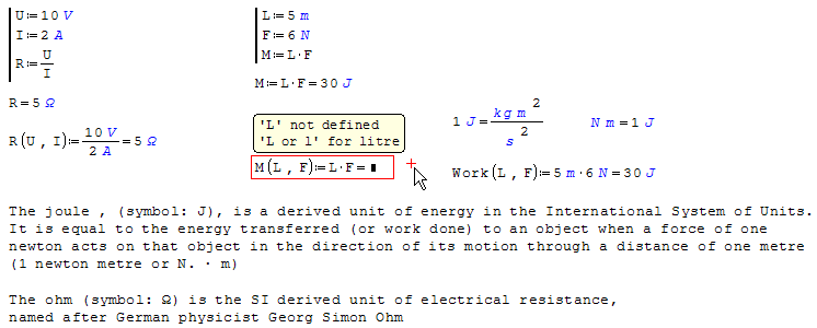

#6 Опубликовано: 25.10.2016 21:27:44
Can anyone advise if it would be feasible to write an extension to accomplish this?
Your 2nd option is redundant. It has no interest in applied
Scientific/Engineering works. Why sould it be of some use
otherwise [teaching/Edu/publishing ...].
That's my answer, not my business.

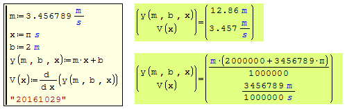

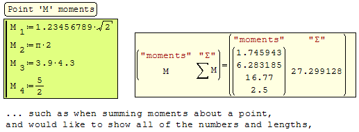

#9 Опубликовано: 26.10.2016 14:04:19
To the wording of your thread "Evaluation of a formula with units"
That is the task of symbolic, that's why the red snippet in my reply.
In Professional works, we define/indentify the contex/units ...
then produce the document(s).
I don't understand your zillions pages long formula.
I don't understand /One page later, /Two pages later,/Three pages later
Attach something: collabs will read .

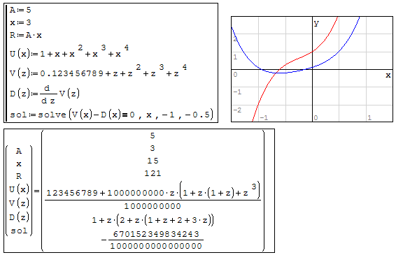

#11 Опубликовано: 27.10.2016 12:51:36
