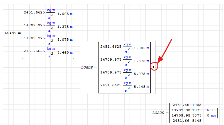

Not sure if I understood but you could show whatever unit is suitable (and consistent) by changing the unit of measure in the displayed results.
Same you would do with a single result, you can change the displayed unit in the black rectangle after results.. only difference from a single formula, is you need to use adiagonal matrix with proper units in proper positions.
At least, this is what I'm often doing to have a clearer view.

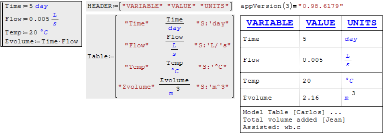

#4 Опубликовано: 04.12.2020 13:57:26
A vector of values can be associated with units.
A data table will have columns units in the header or row wise.
Jadalbert 07.12.2020 08:24:00

... suggestive examples.
Table Scientific.sm (20,56 КиБ) скачан 1219 раз(а).
Table Medic Data.sm (17,51 КиБ) скачан 1244 раз(а).
Inst_Colebrook Pipe Data.sm (71,4 КиБ) скачан 1240 раз(а).
