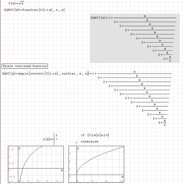

Four examples of Continuous Fractions
Continuous_Fractions_SS7251.sm (79,76 КиБ) скачан 1326 раз(а).
Continuous_Fractions_SS6179.sm (76,96 КиБ) скачан 1291 раз(а).
frapuano 12.02.2020 06:46:00, NDTM Amarasekera 13.02.2020 05:10:00

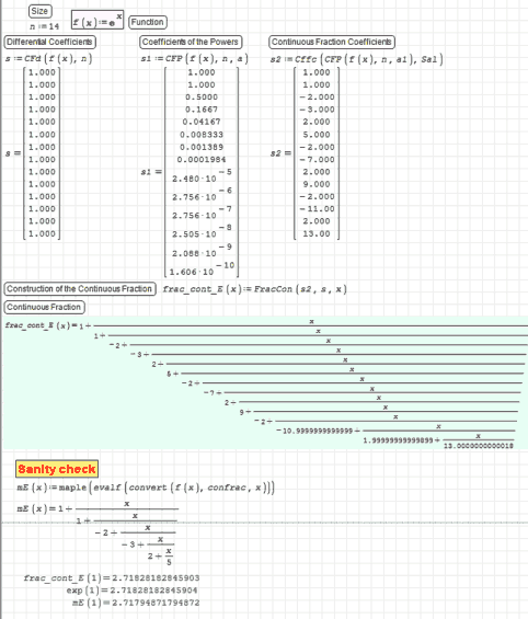

Four examples of Continued Fractions
Thanks Carlos ... works well.
More from Maple ... Jean
Symbolic Convert Parfrac Primary FNCTS.sm (27,81 КиБ) скачан 1270 раз(а).

Hola Jean
Thank you very much for your examples, they have helped me to correct
a fault that was presented in the ACOS (X) function, where the value
of "Phi () / 2" was not included.
I have merged all the algorithms in a single function for ease of use.
All the examples you provided work perfectly with the algorithm for
the conversion of function to a continuous function.
SMATH STUDIO VERSION 7251, DOES NOT ACCEPT THE ACOS (X), ASIN (x) AND
ATAN (X) FUNCTIONS FOR MAPLE, GIVING THE "EMPTY STACK" ERROR.
Continuous_Fraction_algorith_SS7251.sm (76,87 КиБ) скачан 1205 раз(а).
Continuous_Fraction_algorith_SS6179.sm (77,56 КиБ) скачан 1288 раз(а).
