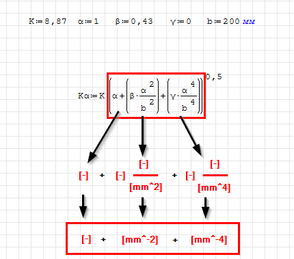

#4 Опубликовано: 02.02.2015 20:11:26
Maybe the attached picture helps a little bit more to understand the issue...
As stated previously, you can't sum apples and oranges; therefore the error message seems consistent...

#6 Опубликовано: 03.02.2015 19:20:22
Thanks for sharing the original formula, this makes more sense; seems you have missed or merged a parameter (alpha) with a variable (a)
Best regards,
Davide
