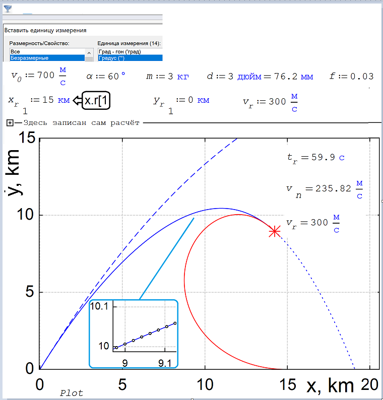

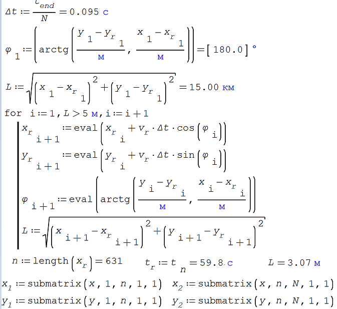

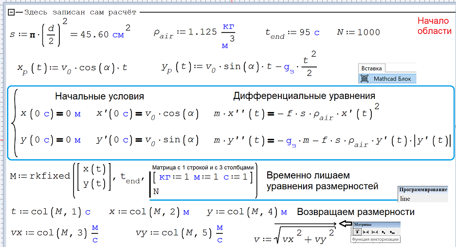

#2 Опубликовано: 31.01.2025 13:51:50
Valery Ochkov
Valery Ochkov

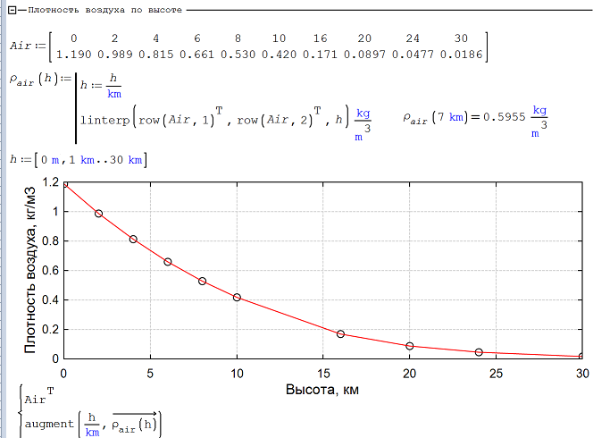

With air resistance
The article (Russian) Iron-Dome.pdf (642,75 КиБ) скачан 1430 раз(а).
SMath-file IronDome-Air-h.sm (47,53 КиБ) скачан 1781 раз(а).
