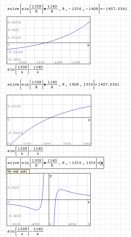

Try, for instance, function solve and solve the equation sin(1.309*x)-1.140*x (there should be three values)
By the way, if we try to plot the function sin(1309*x)-1140*x and zoom in, we are going to see very small numbers with the 15 significant digits on the axis ticks, say x.xxxxxxxxxxxxxxE-xx. This is rather hard to read especially on the x axis. I suppose that there should be used the same number of decimal places as defined under Tools=>Options=>Decimal places, or something else?
WroteThe result iz zero (see the example of finding roots).
Dear Frnds
Actually in excel, values can easily be brought out by using Goal seek option. I am pasting here the same:
Radius Excel Formula and value
C9 - value = cos(1309/C9)-((C9-525)/C9)
1534.578119 -0.000162479
Here I put a additional formula:
sin(1309/R) - L/2R =0.
Radius C7 value Excel Formulae and value
=SIN(1309/C7)-(1140/C7)
1455.558167 -0.000306041
