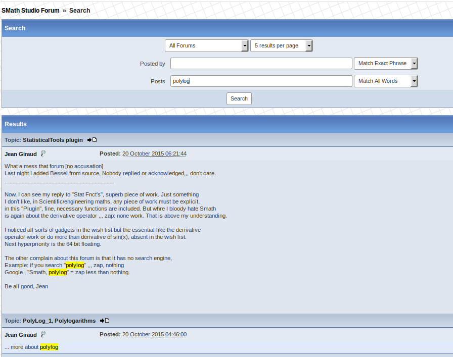

The other complain about this forum is that it has no search engine,
Example: if you search "polylog" ,,, zap, nothing
Google , "Smath, polylog" = zap less than nothing.
Search engine is not ideal, but it can be helpful

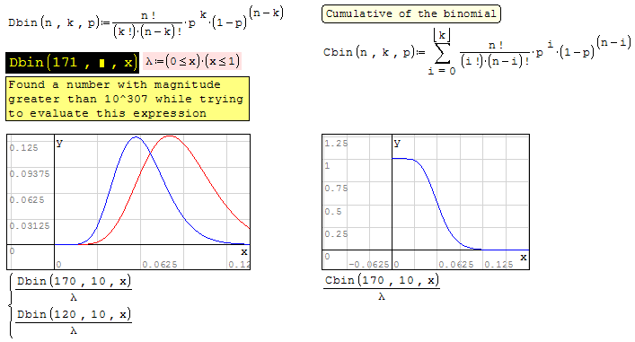

Davide,
Thank you very much for this plug-in. I have a couple of comments.
The CDF for the binomial distribution returns 0 for 0 successes when it should return the same value as the PDF with 0 successes.
The formula that you are using to calculate the PDF uses factorials:
[f(x,n,p):{n!}/{(x!)*((n-x)!)}*p^x*(1-p)^{n-x}]
This limits the value of the number of trial to less than 170 or an overflow occurs (which SMath catches). A better way may be to use the multiplicative formula to calculate the binomial coefficent term of the PDF which won't overflow until 980 and only then when x = n/2. As x tends away from n/2, the number of trials entered can be significantly increased without overflow. In this case, you need to add the condition that if x = 0 then the binomial coefficient = 1 due to a div/0.
Since the CDF just sums over the PDF as x goes from 0 to x, the same issue exists there as well.
None of this is very robust, but it should make the binomial functions a bit more usable.

1. limit 170 => confirmed
2. try to propram "multiplicative"
3. OBSERVE: CDF ... 1-CDF

#35 Опубликовано: 06.05.2018 23:41:38
Thank you both, I'll check it ASAP
Maybe like this above 170 ... ?
Stat Treasury_6 Dbin Multiplicative.sm (13,44 КиБ) скачан 1649 раз(а).

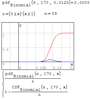

The application that I'm currently working on involves attribute testing and the calculation of confidence and probability of a certain number of events occurring in a set of samples. For example, if there are zero events in 299 trials, then we have 95% confidence that there is a 99% probability that the outcome will not occur.
Some information here from Minitab blog:
http://blog.minitab.com/blog/the-statistical-mentor/how-many-samples-do-you-need-to-be-confident-your-product-is-good
Very useful in product design testing. And depending on the risk involved, we may need to test to higher confidence levels than that, which leads to higher sample sizes, and therefore higher numbers of trials in the binomial distribution.
