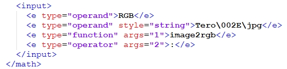

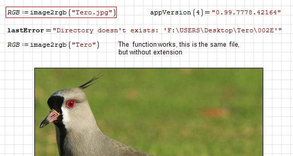

Hi. The error is self explained.
This is the saved file:
Davide Carpi 22.04.2021 08:36:00
#2 Опубликовано: 22.04.2021 08:36:07
Thank you, I'll fix it ASAP.
#3 Опубликовано: 25.04.2021 19:48:26
Fixed and released for the latest beta

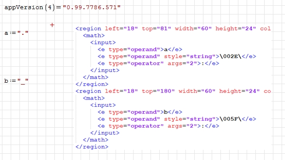

Hi Davide. The issue persists for release "0.99.7786.571":
test.sm (2,38 КиБ) скачан 1495 раз(а).
#5 Опубликовано: 26.04.2021 04:38:06
It works for me even if dots, slashes and underscores are encoded

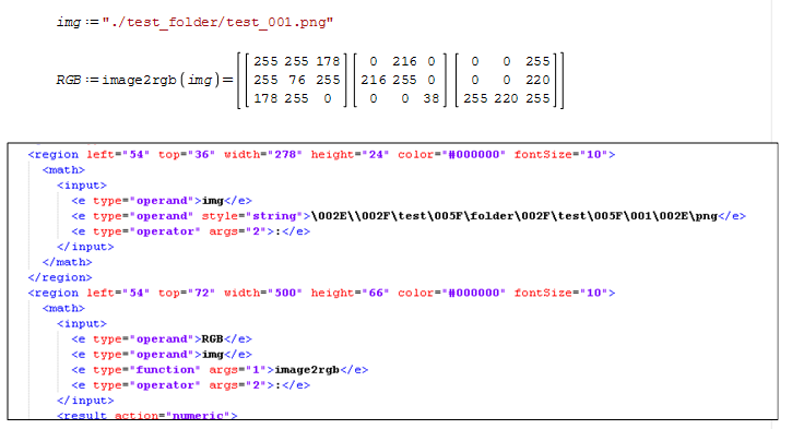

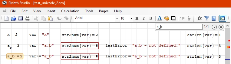

Hi Davide. Yes. you're right, it works with encoded strings now, I see the strings, and no check if can read files with that.
So, standard ASCII characters lower than 128 will be encoded as Unicode? That can introduce a lot of issues for low level manipulation to the user.
test_unicode_2.sm (5,82 КиБ) скачан 1549 раз(а).
Also, the string "a_b" doesn't appear in the search box, but if you search for x, x and "x" appear.
Also, suppose that I want to find an sm file where it's defined the function "my_function_1": I need to search now the string "my\005F\function\005F\1" inside the files?
Thank you! Fixed.
