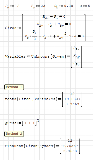

I would like to solve a system of linear equations in Smath Solver as in Mathcad. Is it possible?
https://ibb.co/WgwntqW

#3 Опубликовано: 09.09.2022 10:31:50
Yes, you can. But beware, there are several solvers.
For single equations, solve() is usually enough.
For systems, I try these functions as in order until a result comes;
  • roots()
  • Findroot()
  • al_nleqsolve()
  • maple solve (or maxima)

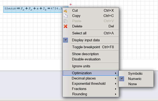

Sorry, I don't know how to put the matrix at the end.
Reakcje.sm (7,59 КиБ) скачан 1327 раз(а).
https://ibb.co/ctpTZ7q
#5 Опубликовано: 09.09.2022 12:39:32
It is obtained by symbolic evaluation.
Since result is only variables.
If you perform a numeric calculation and wish outcome as a number,
then you will need numerical evaluation.
These two can be changed via 'Right click>Optimization'.
