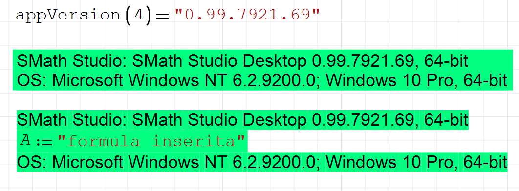

Text region background color don't uniformly applied when it contains an inline formula.
This bug occurs on linux, don't know the current situation under windows.
textregion_bug.sm (3,03 КиБ) скачан 1628 раз(а).
#2 Опубликовано: 07.01.2022 16:14:56
confirmed also for win10
