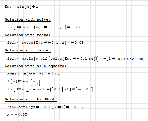

#2 Опубликовано: 29.04.2022 06:19:37
Various examples are possible.
Mathcad Block. FindRoot example.sm (4,81 КиБ) скачан 1317 раз(а).

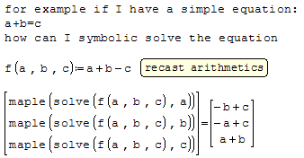

another question:
for example if i have a simple equation:
a+b=c
how can i symbolic solve the equation
so that a=c-b is the result.
If i use solve function all variables need to have a number
I simply want to symbolic solve the equation to a variable without using any numbers asigned to a variable
thank you,
br Stefan

#12 Опубликовано: 03.05.2022 15:53:56
thank you,
can you provide me with the smath file so that i can look into? Thank you br Stefan
Notice the optimizations are set to symbolic to view results.
You can check and set optimization of individual regions by right click.
symbolic.sm (4,21 КиБ) скачан 1306 раз(а).

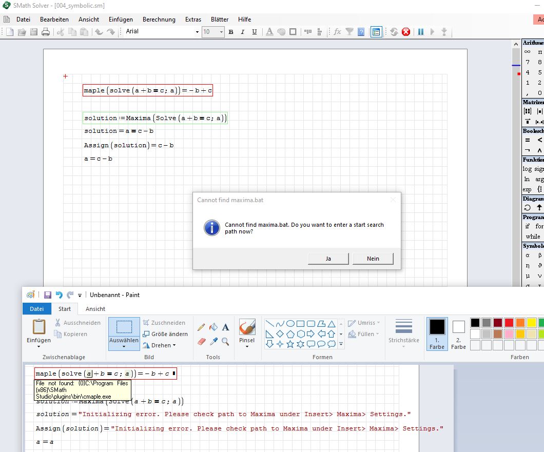

#13 Опубликовано: 04.05.2022 06:14:37
Stefan Müller
Stefan Müller
0 сообщений из 45 понравились пользователям.
Thank you but i have a problem i downloaded the latest version
i downloaded maxima plugin and others but i do get a failure when opening your file see attached picture
There is a file missing:
cmaple.exe / maxima.bat missing
What can i do ?
however smath says maxima plugin is installed:
Thank you br Stefan
#14 Опубликовано: 04.05.2022 06:42:10
What can i do ?
Thank you br Stefan

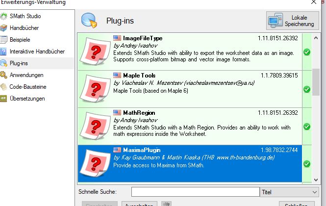

It seems your mentioned firewall settings prevented proper installation of Maple plugin.
Usually SMath plugins are saved under this path in Windows 10.
C:\Users\/AppData/Roaming/SMath/extensions/plugins/
I can copy my plugins directory on Windows partition and upload it for you to download and copy/overwrite.
But it won't be a convenient way to install plugins. Set an exception to your firewall for SMath downloads.
Maxima is another subject, plugin seems installed but you will need Maxima software to make it work.
Latest version can be downloaded and installed from link below.
https://netix.dl.sourceforge.net/project/maxima/Maxima-Windows/5.46.0-Windows/maxima-5.46.0-win64.exe
You also have to set the path for Maxima.bat under Insert>Maxima control windows>Settings menu.

o ok
i need maxima software in order to work properly?
I was thinking the plugin only is enough?
Thank you for the input!
Yes please upload your plugins folder since i cannot download the plugins in the software due to firewall
But what plugin is there required under bin "cmaple.exe"
What he cannot find?

ok thank you but now im a little bit confused.
I searched maple plugin herer:
https://en.smath.com/list/plugins
but i cannot find the plugin
software needs cmaple.exe in order to work. Where do i find this?
Thank you br Stefan
#20 Опубликовано: 04.05.2022 08:10:28
https://smath.info:8443/!/#public/view/head/plugins/MapleTools/Resources
It is in cmaple.zip file on this page.
It is in also plugin.zip file I uploaded for you.
